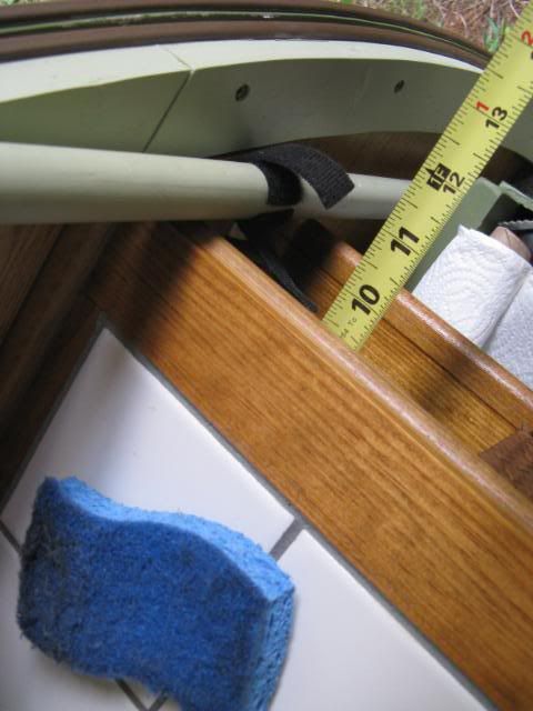

Postby BillZ » Tue Aug 09, 2011 4:49 pm
I am planning to build wood drawers to replace the fiber ones in my galley. As you can see in the 2nd pic, they can only be about 9 1/2" deep. The shortest drawer slides I can find are 12". I am looking either for shorter drawer slides or a different method of drawer construction that doesn't require the standard rollers.
I plan to build 3 rather wide drawers across the area where you see the current fiber ones. The extra width will allow for utensils and things such as foil wrap that can't fit longways.
Any help is appreciated!
BillZ

Accuride has slides from 8 inches and up, in two inch increments, in their 2632 series
