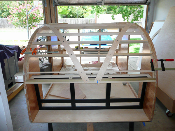

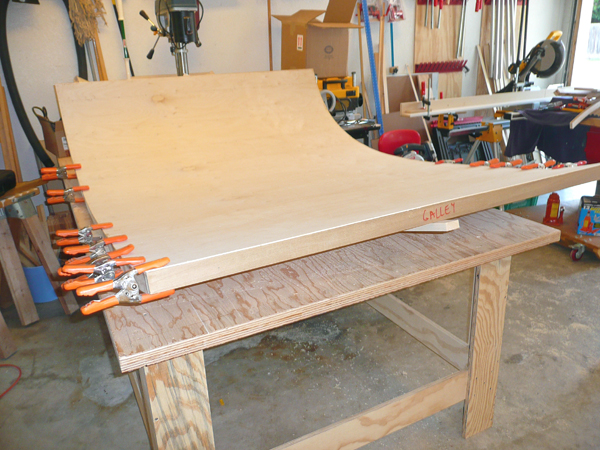

There are many ways to approach the task. I was working by myself so what I did was build my roof framing so that it was removable. Then I added so temporary cross straps, removed the roof framing to the work bench, added the plywood, and added the carpeting. (Actually I used marine hull-liner.) It was easier for me to work with the roof upside down on the bench rather than overhead. Then I installed the finished assembly back in the teardrop.

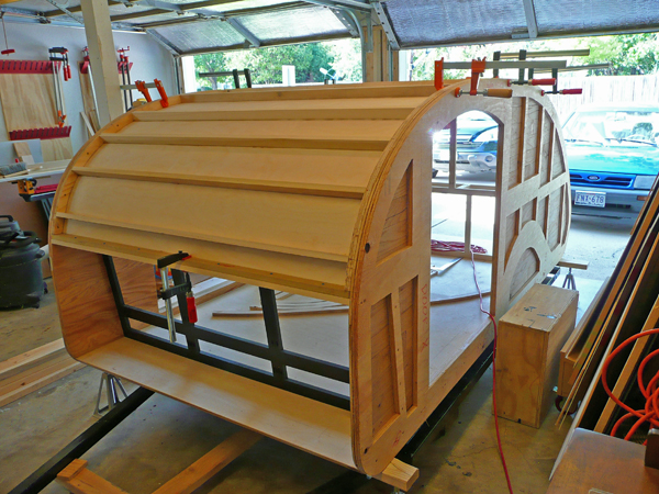

I put hull liner (like carpet) on my walls and I applied it before I put the walls in place. Much easier to do while horizontal.
I could have done the same with my ceiling but I chose to make it exposed wood. My ceiling just lays on top of the sandwiched walls and then the spars are installed on top of it.
