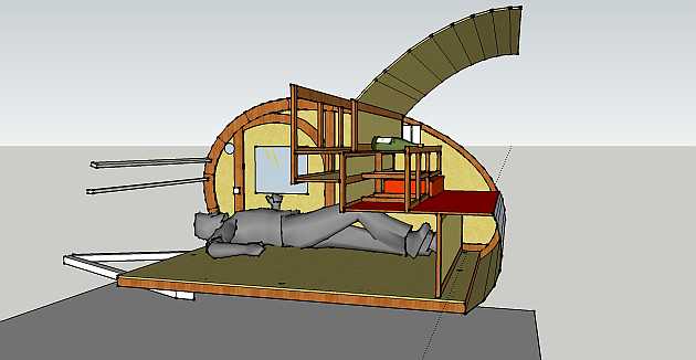

Another great tool is Google Sketchup. It allows you to design in 3d and create plans accurate enough to build off of. I spent an entire winter designing my teardrop before even going out to the shop. Best thing is - it's free.
I agonized quite a bit about axle placement and a few other things. After researching this forum and looking at plans, I came up with a placement, had it welded, and haven't thought about it since. Haven't towed it yet, but it looks right, and I'm sure it will be fine.
I found planning to be almost as fun as building. Even though many changes were made along the way, it was nice to have an accurate plan I could refer back to. It made things a little less scary. Giving up on perfection right away also helped. It makes the goofs along the way matter a little less, like the scratches I put in the aluminum yesterday.
