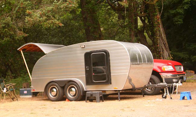

...there have been quite a few Tds built on boat trailer frames...just keep in mind the balance issues cited above...a dual axle is a bit of overkill BUT the beauty of these builds is doing what you wanna do(as long as it's safe)...........

I believe jdarkoregon built his on a tandem axle boat trailer...
