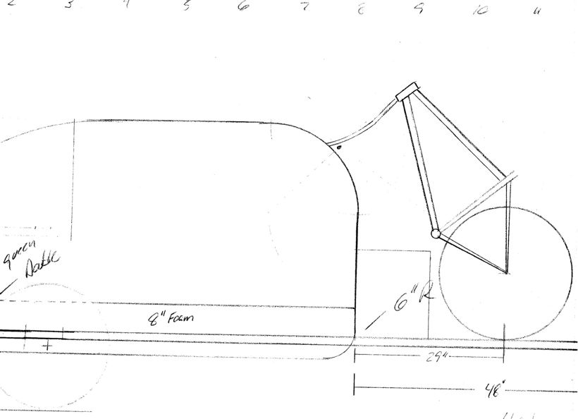

I see these remove-a-wheel bike racks all the time on sport wangons or in pickup beds. Can anyone point me to photos of something like this on a teardrop?

Postby dh » Fri Aug 26, 2011 4:45 am
One problem I see, what happens when you upgrade bikes? You would have to have pretty darn near the same wheel base amd frame geometry. Other than that, it looks like a why not. Nashbar or Performance should have the fork mounts and rear wheel trays. Are you gonna put the front wheel in the tear?

Postby chartle » Fri Aug 26, 2011 8:43 am
I assume you mean these kinds of racks.
Not sure if it would work. I have never seen them mounted in anyway besides horizontal.
Mounting them your way could put stresses on the bike that it wasn't designed for.
Of course there is the whole idea of how it stresses the TD. Also you would have to increase your tongue length.
It would be better to put roof racks on your TD and use the bike mounts as they were designed to be used.
Somewhere here I saw a source for roof rack mounts for a TD.

Postby Thawley » Fri Aug 26, 2011 8:44 am
dh wrote:Are you gonna put the front wheel in the tear?
I was kinda thinking about using a wheel holder like this somewhere down on the tongue – near the rear wheels, though no necessarilywith the axles in line.
Good comment about the wheelbase. I'm not really a bike guy. If we're taking about road bikes and 26" mountain bikes, do they vary more than 2-3"?

Postby Thawley » Fri Aug 26, 2011 8:54 am
chartle wrote:Of course there is the whole idea of how it stresses the TD. Also you would have to increase your tongue length.
Stress to the TD is the bigger concern, I think. Have to build in and extra beefy spar for this very purpose.
As for tongue lenth, I had an extreemly long one on our first TD and loved it. Planning to do the next one that way too.
Hoping to keep the roof free for:
    better aero
    shorter reach
    option to put a surf rack there in addition to the bike rack

Postby chartle » Fri Aug 26, 2011 9:33 am
I'm thinking metal, possibly something like a roof rack attached to the sides and away from the skin. From there your side walls would have to have some sort of diagonal bracing to the floor.

Postby dh » Fri Aug 26, 2011 9:14 pm
You could stick with the fork mount/wheel tray pictured, just go crosswise with it...
Mounting a bike like pictured in the OP is no big deal. If that put undue stress on the bike it would be so porely built I wouldn't want to ride it. I put a lot more stress on a Mt bike when I ride it than that would.
HF sells a hitch mounted bike carrier that folds down for access to the back of the vehicle, not sure if it would clear a TD hatch, but it might be another option.
Oh ya, Bikes (good ones anyway) come is different frame sizes, coupled with geometry changes which affect how they ride, you could easily see a difference of 6" in wheelbase between two randomly selected bikes.

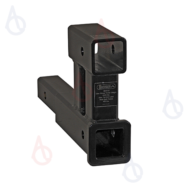

Dual receiver
Postby Oldragbaggers » Fri Aug 26, 2011 10:21 pm
How about a dual receiver on the back of the tow vehicle like this
You could hitch your teardrop to the lower one and put your bikerack in the upper. This might not be the best product, but the general idea could be implemented somehow. Might that possibly work?
