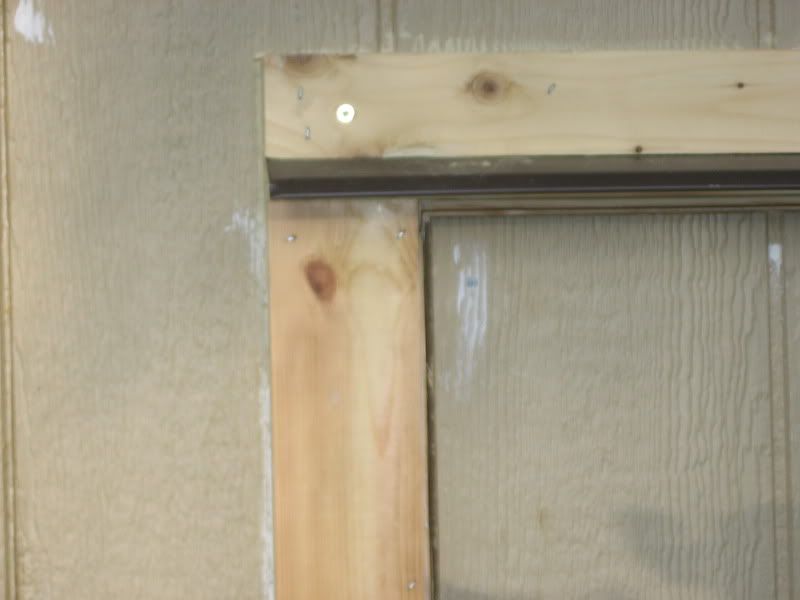

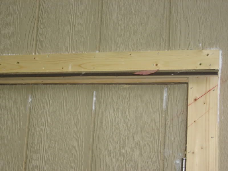

Postby Mikka » Wed Sep 14, 2011 6:28 am
Not on a camper, but i did drip edges on a shed with doors facing north. I made the door myself and was concerned with water seeping in during storms. All i did, I cut the top trim at a 45 degree angle and inserted a piece of `Z`flashing from HD. works very well for my application. Hope it helps photos showing details.
Shed details here: http://smg.photobucket.com/albums/v378/ ... 1QQtppZZ20
