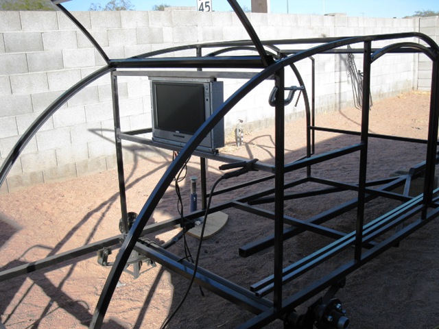

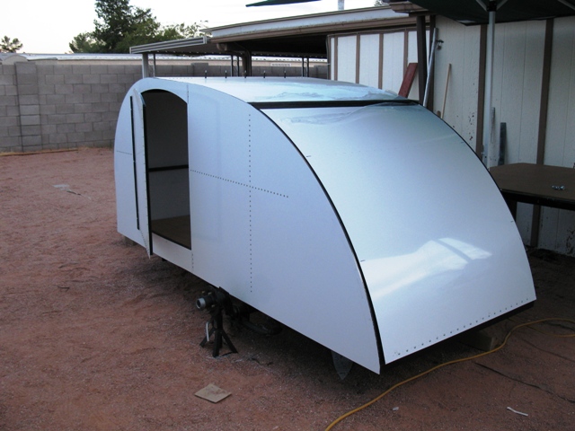

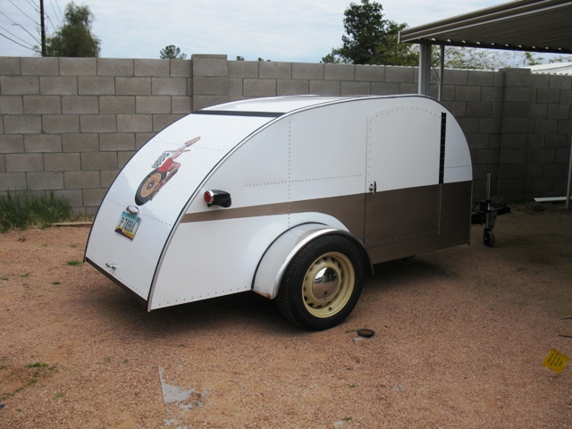

Postby emiller » Sun Oct 02, 2011 8:27 pm
I used olympic rivets from Vintage Trailer Supply
