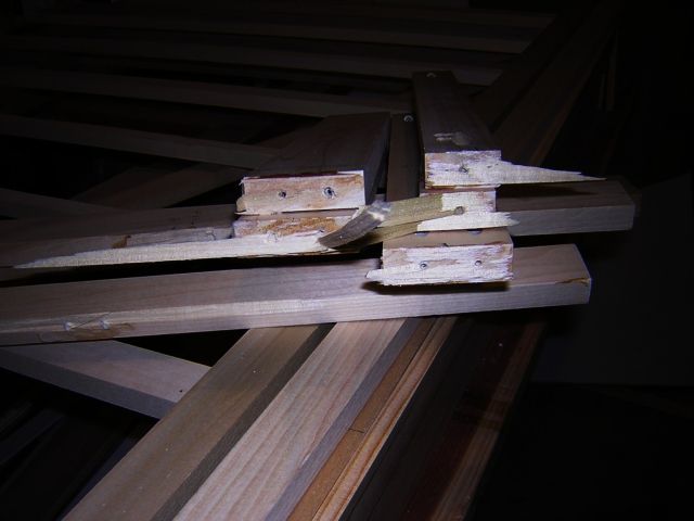

PS. For bare wood to bare wood gluing, my favorite is TitebondIII. The wood will usually break before the bond does:
For epoxied wood, I use PL Construction glue.
