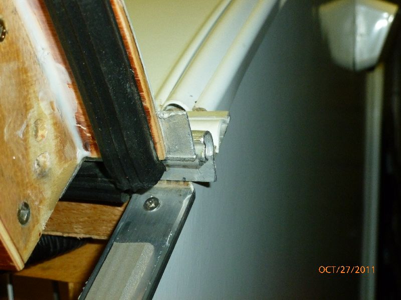

Postby JeepThing » Thu Oct 27, 2011 6:03 pm
Thanks for the ideas, here is a picture of how much my hinge hangs over I thought it would be enough but still getting water. I'm wandering if there is a way to now attach something added to the hatch or wall or hinge that will not get in the way of closing the hatch?

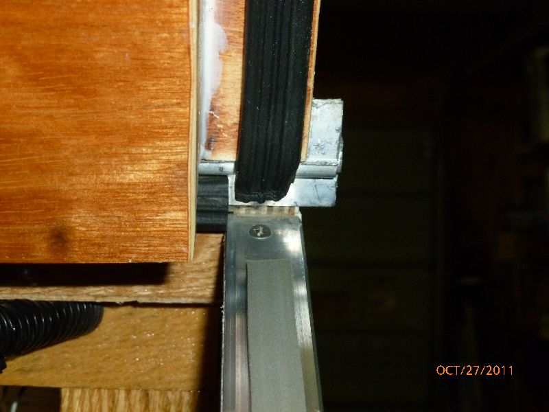

Postby JeepThing » Thu Oct 27, 2011 6:11 pm
Another View: I also plan on adding to the hatch edge, an edge moulding same as the roof mouldings (with a longer leg)you see in this picture. I just haven't yet and will need to include this into any ideas.

Postby halfdome, Danny » Thu Oct 27, 2011 8:02 pm
The rain diverter I make fits in the gap of the hurricane hinge tight to the body side. Make one and you'll see how it works. :D Danny

Postby halfdome, Danny » Fri Oct 28, 2011 7:51 am
JeepThing wrote:Thanks Danny, Did you use aluminum angle to make this piece, in the pcture it says you welded a household hinge ? not sure how to make what your talking about. :thinking:
The welded household hinges referrs to the gas strut. It's an old photo in my album.
I use a 3/4" piece of aluminum angle about 3 1/2" long and notch it out on one side of the angle to fit into the hinge gap. The notch is cut at an angle to fit snugly to the bottom of the insert molding. On my TD it ended up as a 3/4" long piece of half of the aluminum angle. I bend it to the appropriate angle to match the hinge angle in relationship to the trailer so the rest of the unmolested angle is plumb with the level trailer. This piece of angle when properly caulked makes run off from the roof edge of the hinge run down the side of the teardrop wall. :D Danny
