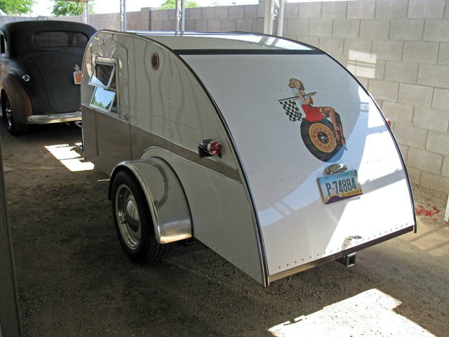

I put mine inline with my tow vehicle.
emiller
Posts: 3421
Images: 157
Location: Arizona, Phoenix

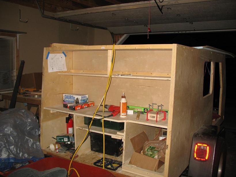

While my little teardrop is a small target there is no way on God's green earth the fellow motorist can sat he didn't see me. Two seperate and redundant complete sets of tail lights. There are 6 amber side clearance and 2 red on the rear side clearance. I also placed 6 ? 8? small peel and stick reflectors low on the hatch.
However......
I was very guilty with the barn leaving the original stock lights in place making for poor rear visibility. That is the reason I added a 3rd stop light to help a bit. I didn't want to take away from the barn look. I know that is a poor reason :oops:
I hid it in the lantern.
(The little "security light" is a battery powered LED area light)
