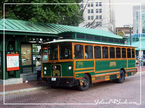

BoBhenry that is bad ass :D :worship: im designing a trolley top teardrop and the very top of the trolley top i want "see through ...what kind of plexiglass and does it bend , secure easy ??

tathead41 wrote:BoBhenry that is bad ass :D :worship: im designing a trolley top teardrop and the very top of the trolley top i want "see through ...what kind of plexiglass and does it bend , secure easy ??
If I were designing a trolley top I would utilize a solid roof and rim with a mass of windows. This will give you the night views and still offer shade at high noon.
The rear window could become the permanent home for a small window shaker air conditioning unit.
In answer to your fabrication question the 1/4 lexan I used machined just like 3/8 to 1/2 plywood with one exception , if not supported well during a cut it will finish the cut on its own and the resulting crack may not go in the desired direction. It will saw, drill, and router just like wood. I found the best fabrication tool for more detailed cuts was a small 4" grinder equiped with a cut off wheel. The same grinder equiped with a 60 grit sanding disc will smooth and further shape cuts. Pre drill all fastner holes oversize and disperse fastner pressure with some type of washer or rosette to avoid pressure fractures.
Bending will be more a factor of thickness and composition.
Plexaglas will bend far better than lexan while lexan will withstand greater impacts than the plex so all have benefits. The biggest benefit to the choice of either is they will not delaminate of water rot and never requires repainting :lol:
