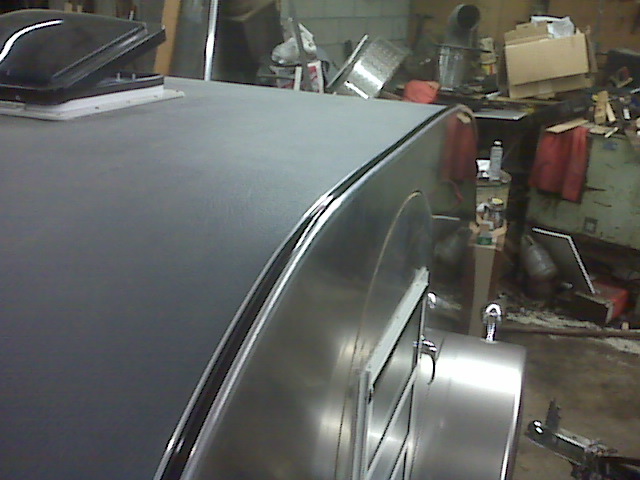

Postby Alleged User » Fri Nov 04, 2011 7:22 am
A few of us have used marine vinyl to skin our roofs. We like the look, and it's easy to change out should we need to for whatever reason. Comes in a ton of colors, but we used a slate gray to match the aluminum. My brother also used vinyl for the roof of his cabin car. We're very happy with the results.

Postby Alleged User » Fri Nov 04, 2011 8:26 am
We actually didn't use an adhesive. It floats on top of the ply, and the roof trim tacks it in place. That way it can breathe in hot temps. This also makes it easy to change out and replace if and when we need to.

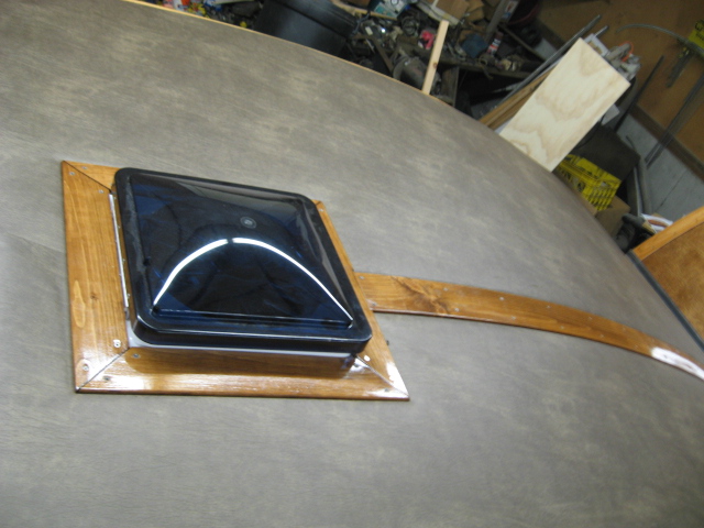

Postby boomboomtulum » Thu Nov 10, 2011 7:15 pm
I also used vinyl on the roof. It is not attached in the field, just along the edges and in the center where the vent is mounted. The edges are trimmed in aluminum. Under the vinyl is 1/4 foam to give some depth, it is glued down to the top, but the vinyl floats.
Check the link below for a photo
http://www.mikenchell.com/forums/album_ ... c_id=37109
