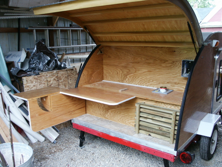

There are other options. Take a look at our album and the pic of the galley area.
http://www.mikenchell.com/forums/album_thumbnail.php?pic_id=1863 I hope I did this right!
We took Steve Frederick's idea and expanded it a bit. You can do the same. It's not horribly difficult to do and your wife will appreciate not barking her shins on the end of the TD. When we were building our TD, I insisted on having more food preparation room - which paid out very well while making a veggie lasagna in a dutch oven. No leaning over to reach anything on the counter, either.
AJ
Thanks for the correction!

Yep, that would work except I am using something similar to the Cub/Modernistic profile like this
But I don't want to lift the counter to get at the space underneath and I don't really want to wrap the hatch down around, soooo that's why I decided on the barn doors, plus there's the added bonus of a little extra storage in the hollow of the door. It'll just take a little bit of trial and ERROR to get it all lined up I suppose.
One of my concerns was sidewall strength with the doors open, but after I thought about the layout of the galley I concluded that the counter and lower cabinets will be close enough to the rear to give it the neccesary ridgidity in that area.
BTW - I like the way the counters are set up, particularly the swingout brace, very nice idea.
Rich

You're right. However, another option is to have the counter top swing the OTHER way, towards the upper cabinets. You'd have to watch clearance of the door and other stuff . . . . . And it would get rather crowded with other gear in there. Hmmmm.
Oh, well. If you are basing your design on that profile, then about your options are limited.
Lets see. One more idea. How about a countertop that rolls out of a sleeved area? You know, like a keyboard tray under a desk. The hardware is easily available from most cabinet specialty stores. You wouldn't even need a door on the panel. Just a pin or something to keep the countertop from moving while you are in transit. Something to think about.
Sorry. I guess I am just fixated on the additional counterspace and ease of use (not barking shins).
Re: the swingout brace on ours. It helps to keep the counter stabilized when it is open. Just gotta watch how the hinge is attached so that the counter is actually level as compared to the folded down section of the counter. Ours didn't work out exactly as planned, but it is pretty close.
AJ.
