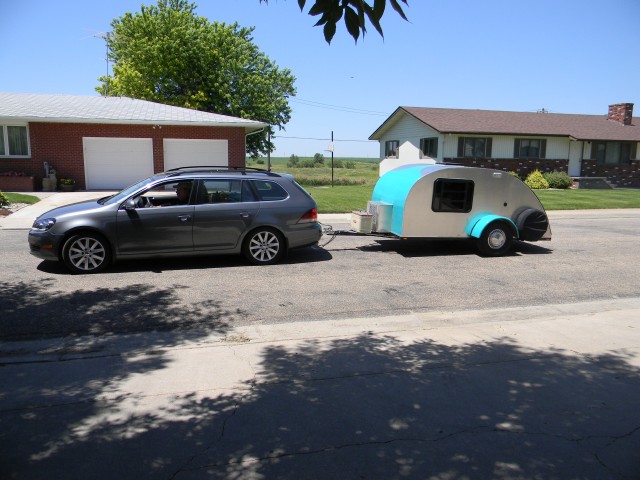

Wow ! That is EXACTLY what my wife said! She wanted a large window to not feel closed in, and though my window is smaller than you are plannng on, it still gives a nice view.
Now we keep the curtains closed on it mostly and I kinda wish we had two doors with nice windows in them. The feeling of being closed in for her disappeared after we got it out of the garage and got in for the first time. What we thought might be a claustraphobic type problem was really nothing to worry about.
My window is one of those "escape" windows and has never leaked a drop, but then again it is not on a 35 degree angle.
