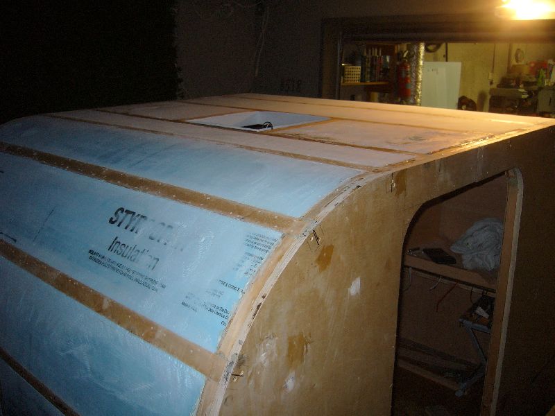

Postby JeepThing » Tue Nov 22, 2011 8:25 pm
On my build I did use 1.5" spars 12-14" apart at the roof vent I used 2"w x1.5 cross braces, covered with 1/4" door skin glued and screwed. the ceiling also has 1/8" door skin glued and stapled to it plus 1.5" ridgit styrofoam glued with PL prem. alltogether they become one piece and are incredibly strong I can stand on my roof with no signs of sagging. Now we'll have to see what a year or two will show but for now it is still perfectly true. Without spars I would think for the few pounds you would save it would not be worth it. It also gives a place to screw cabinets into and maybe other things to attach too. Good luck
A pic of my roof spars w/ insulation
P.S. Rob - I realy like that old photo very cool to see them being build in the ol' days
