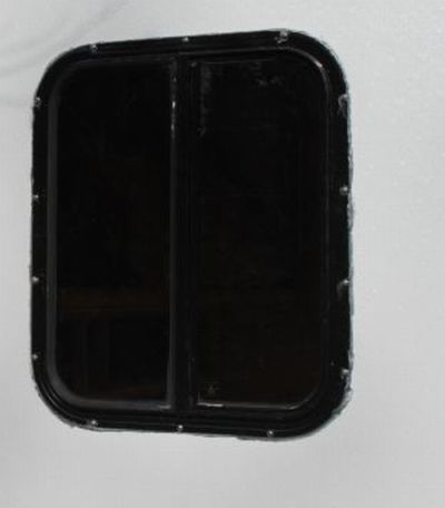

In this build we are salvaging some old treasures. Some of the wood is from old cabinet shelves and other items that had been demolished. I will have a window on each side, one fixxed and one a slider for ventilation. The slider came from a 1971 Pace Arrow RV that was recently destroyed for scrap. The window will live on in our TTT. Was able to save a few more parts also, but the other windows were all broken before I could get them.
