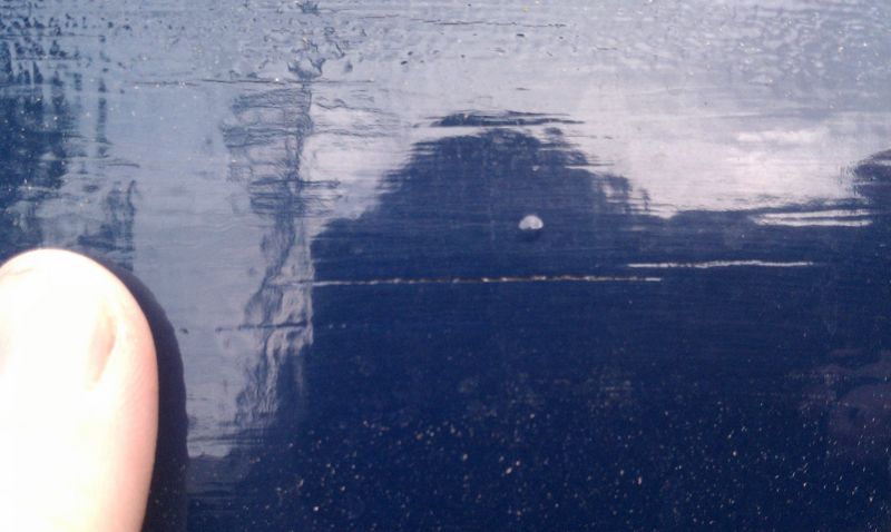

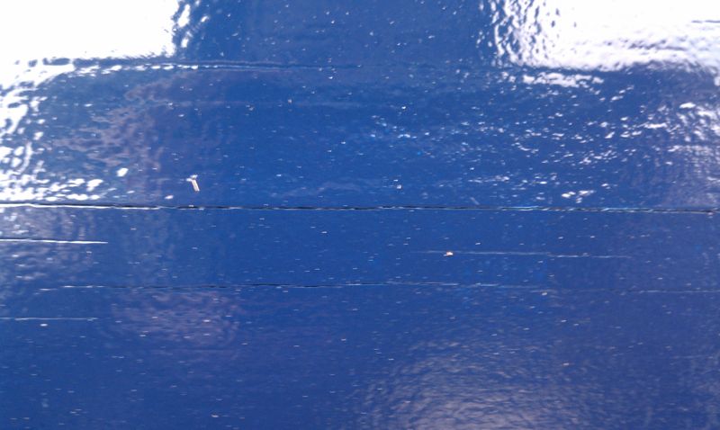

Postby DavieBoot » Sat Jan 14, 2012 2:11 pm
Okay here are some photos. I'm not sure it's because the coating was too thick. As the area where the cracks are actually was missing a coat of paint. And since it's marine paint it's supposed to be able to expand and contract.
There's one more part of this mystery that I haven't mentioned. The trailer has a liscense plate on it, and the area under the liscense plate has no cracks.
Okay so here goes:

Postby Gage » Sat Jan 14, 2012 5:21 pm
How about giving a wider shot and mark where the cracks are with a marker of some kind. Those pictures you have posted looks like they are cracks with the grain. :thinking:
