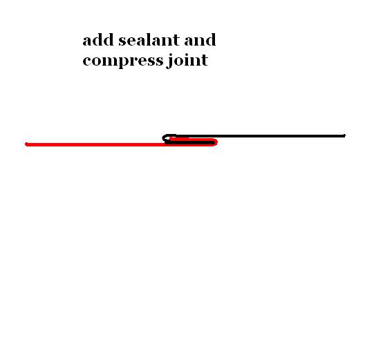

You might give a thought to 24" aluminum flashing it comes pre painted chocolate brown on one side and white on the other. With an aluminum brake ( bending tool) you can bend a hook on each piece and have the flashing come out exactly 40" then simply add some ell shaped edging and your roof is done, No fumes no drying time.
