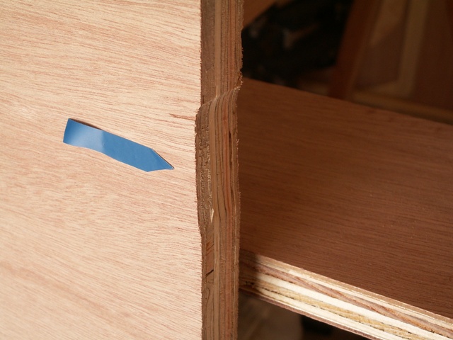

Well now I've done it. I had a momentary lapse in concentration and let the router wiggle while trimming the door spacers. It left about a 2" x 1/8" gouge on the back edge (latch side) of the door frame. Sadly it's on the outside wall so it's very visible to me. We are hoping to stain and seal the outside of our trailer with epoxy so I'll need a way to hide this. Does anyone have any suggestions? At the moment I can only of a few things to try.

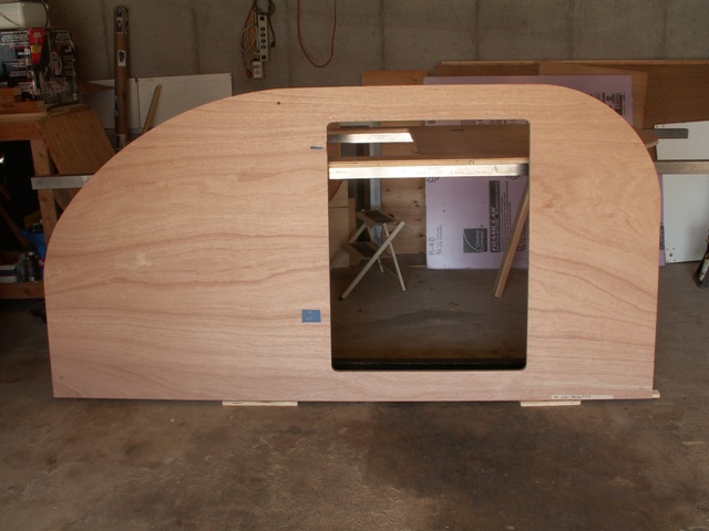

Here's a picture of the gouge.
The gouge is located along the back edge (not the hinge side) of the door opening about 3" below the corner. Look for the small blue piece of tape.

Postby 48Rob » Sat Jan 28, 2012 8:34 am
Can you show a larger picture, one that shows the entire door or side of the trailer?
It sounds like you plan to stain and use a clear finish, but you have two different types of plywood...
If we can see the "whole" picture, maybe one of us can come up with a creative fix to make it look as if it was planned.

Postby PSBreen » Sat Jan 28, 2012 11:02 am
Rob,
Updated pictures in post# 1
There are two types of ply in our walls, they are 3/4" ACX with 1/8" luan skins. We are still hoping to use stain and epoxy on the outside of the trailer.
The gouge is on the back edge (not the hinge side) of the door opening, about 3" below the top corner. So far it's looking like the "Dutchman" patch may be a good place to start. It would at least get the edge of the opening straightened out. Not quite sure what to try after that. Aluminum trim with a 1/8" lip is a possibility, but I'm not sure I can form it around the 1" radius corners.

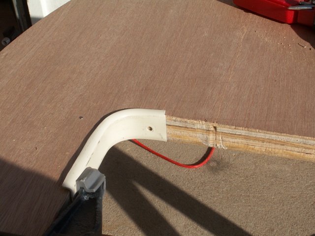

Postby PSBreen » Sat Jan 28, 2012 5:20 pm
I have a Dutchman style patch in place. Waiting on the glue to dry so we can sand it and see how it looks. I'm kind of at a stand still for the moment. So I figured I'd see if it's possible to bend a piece of trim around a corner. I took a small piece of edge trim and cut the lip down to 1/4". It formed pretty well. I just had to go slow and keep flattening the lip. This may be a possible solution to cover up the gouge.

Postby PSBreen » Sat Jan 28, 2012 7:30 pm
We gave the "Dutchman" patch a try. It really doesn't look half bad, considering it hasn't been sanded yet.
We are using Steve Frederick's door seal method and were planning to coat the edges of the door and it's opening with epoxy. There are several ideas on here that are looking real interesting. I know one thing for sure, I will not use 1" radius corners on the door on our next build. They really throw a kink into repairs. The next one will have square corners or a gentle curved edge.
