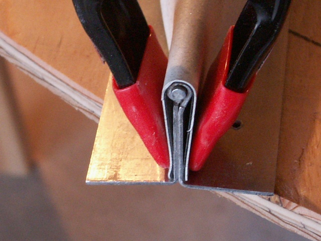

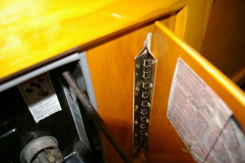

Here are some pictures of how I did mine, they aren't glued on, but rather just held by the hinge screws.
They work very well, but as with any fabric exposed to the great outdoors, at some point it will fail and need to be replaced.
Note that a dab of sealant at the top will keep water out.
Rob
