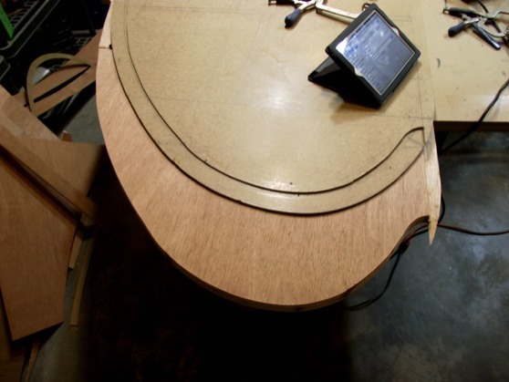

Hello all.
I just finished cutting out my hatch side from my wall. I cut a pattern at the same time so I could copy it over to the other side. After the cut I decided to see how it would look like and tried to move it out like it would when the hatch is built. Because of the curvature of the wall the hatch side seems to bind at the bottom. Did I extend the hatch side down too far? It now sits flush with where the floor will be. I hope pictures might explain it better. The design is based on the new cub from the design library, but the floor is lower, or the body sits higher, which ever.
As always any advice is Greatly appreciated.

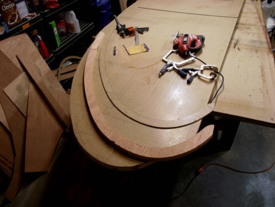

Postby Koko65 » Thu Feb 23, 2012 12:35 am
Here is another shot of the cut out hatch side.

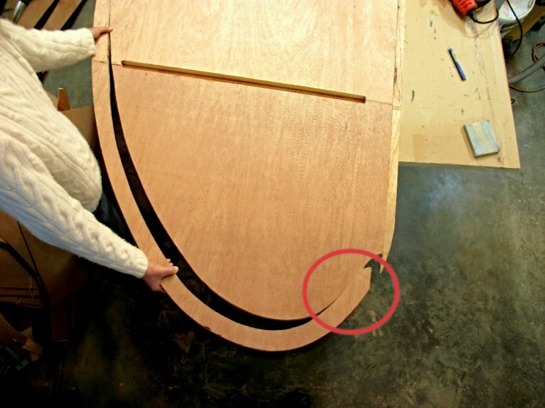

Postby Koko65 » Thu Feb 23, 2012 7:51 pm
Thanks for the tips. Below is another shot of the situation that might make it more clear. My wife is holding the hatch side just as it would move through it's arc when it would be opened. I circled where the binding is occurring. I should note that I am using the shop manual be Steve Frederick, so the hatch sides will sit flush with the outside wall. I could cut the bottom portion off and re-attach it to the wall. Then when I build the hatch the sides would have a little jog on either side before continuing down to the floor.
Hope this makes my dilemma more clear.

Postby Corwin C » Fri Feb 24, 2012 1:50 am
I'm glad you posted this. I just looked at the design that I'm working on, and I've created the same "snag" in mine. A fix would be to draw a radius from the hinge line to the end of your "hook" to establish the parting line for the hatch. This would keep it from catching itself, but it keeps the hatch from having a parallel curve aesthetically. A double hinge would also fix it, but that would add a whole lot of complexity.
I guess this explains why so many cub/modernaire designs have a hatch that doesn't go all the way down.
I'm going to have to look at this closely ... at this point, I really don't want to alter my profile, and my galley design will not work if I can't open the hatch all the way to the floor.

Postby pohukai » Sun Feb 26, 2012 9:59 pm
Change your hatch design to stop at the blue line.

Postby chartle » Sun Feb 26, 2012 11:05 pm
I think you could also move the hinge point back along the curve, but in this configuration, yes you messed up your hatch.

Postby Koko65 » Sun Feb 26, 2012 11:30 pm
I think I'll try cutting the hatch side similar to the above suggestion. Then once the hatch is past the wall I will continue it down to the floor. I need to trim it about 6" from the bottom in order for it to clear. Then when the hatch is done I can add some extra wood on the bottom section of the wall for some weather stripping. I'll do some experimenting on my next day off and post some more pics with the results.

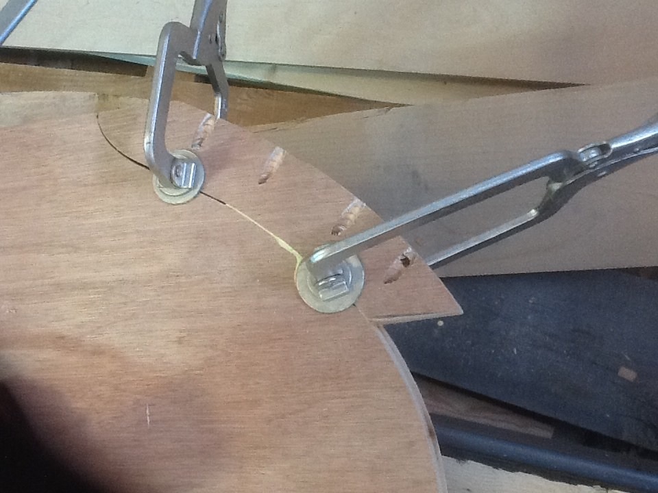

Did I just screw up my hatch?
Postby Koko65 » Tue Feb 28, 2012 4:29 pm
I decided to cut the lower portion off and re-attach it to the wall. The inside of the galley still gets another skin so this will be covered over and strengthened.
