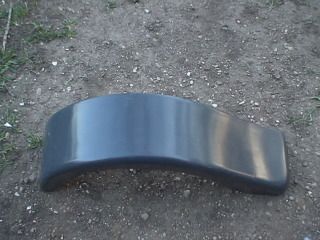

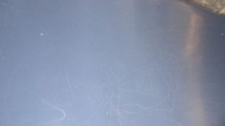

Got some of Grant's lil fenders, and think I going to attempt paint myself(thinking spray can). There are some cracks(?) in the gel coat. Based on advice from a supposed expert coworker, I am thinking scuff the gel coat, high build primer, block sand, another coat of primer, block sand, repeat as necessary until fenders are smooth, then color coat, scuff, another color coat. Does this sound right? Also there are a few spots that could use some body filler, at what point do I do the filler? I am planning on spray can bed liner or undercoat on the undersides. What grit sandpaper do I use at which points?
Fender
Close up showing cracks

Those "cracks" are simply stress fractures in the mold that have "patterned" through (I'm gonna kill my brother, those should have never gone out looking like that :x !), and they'll sand right out ... start with some 400 grit wet-or-dry, then 600 grit ... no need to prime, as the gelcote is its own primer (call Primacote). If those spots you say might need filling don't sand out and you DO need to add filler, then you'll need to prime those spots (wonder how many lives my brother has ...?). Regarding sanding the paint between coats, consult the directions on the can, or ask the guy behind the counter at a reputable paint shop. Yep, rattle-can bedliner is a good way to go ... better would be to get the real thing (a little spendy, but you'll get the best results).
