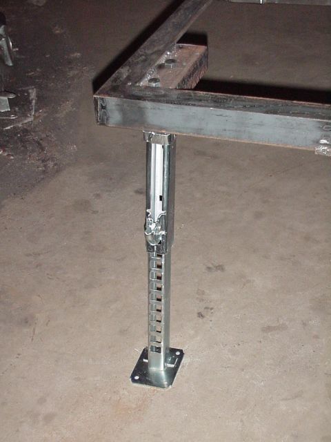

Powder,
I have a pair of aluminum screw type jack stands, I put one under each front corner of the frame then lower the tongue jack to the point where the trailer appears level and there is still a slight load on the tongue jack, it nearly eliminated movement of the trailer during the night. I also use wheelchocks for the trailer wheels. On my recent trip to Bonneville, I packed a friend's 16 year old son along. He camped out in the back of the truck while I was in the tear, my mistake the first night was to leave the trailer hooked up to the truck. Every time that kid rolled over in the back of the truck it shook the heck out of the trailer and woke me up. :x Funny thing is though, the next morning he tried to blame the quake on me. :fb Needless to say, from that point on the trailer gets disconnected. :thumbsup: Here's the type I use.

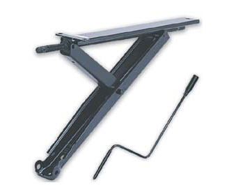

I really like the BAL T-Type stabilizer jacks. They are a few dollars more, and worth every penny.
They call them stabilizer jacks, because they are designed to stabilize your trailer, not lift it. But our teardrops are so light, that we can lift, level, or stabilize... your choice!
http://www.pplmotorhomes.com/parts/rv-j ... -jacks.htm
Postby DestinDave » Sun Sep 11, 2005 6:07 am
Mike, thanks for that link to PPL... Since the BAL jacks were on sale there until 09/16 I went ahead and ordered a set this morning. One question for you - in the pic you posted, there are mounting holes on the end of the adjusting leg. Are those to mount a "foot" and it just isn't shown in the picture?

Postby mikeschn » Sun Sep 11, 2005 8:08 am
Yes there are optional base pads that you can buy... they are quite nice actually... I had them on the Baja Benroy... Here's some information on them... go to the bottom of this page...
http://www.norcoind.com/bal/products/co ... abjack.htm
