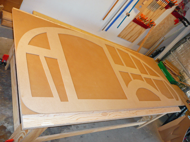

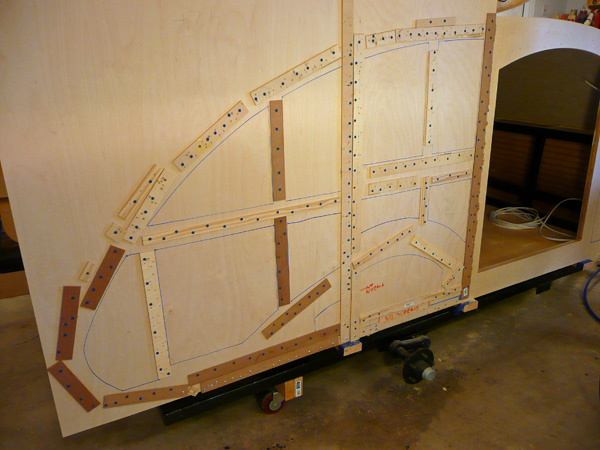

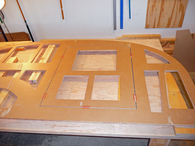

Postby aggie79 » Mon Apr 16, 2012 7:53 am
I used the "uni-frame" method too.
Before cutting expensive plywood, I made a template out of 1/4" MDF. Then I traced the outline on top of the plywood, rough cut it with a jig saw, and finished cutting it with a router.
As far as attaching the 1/8" plywood sides, I used temporary screws through scraps of plywood to apply pressure to glue joints. Later, the holes were filled.
