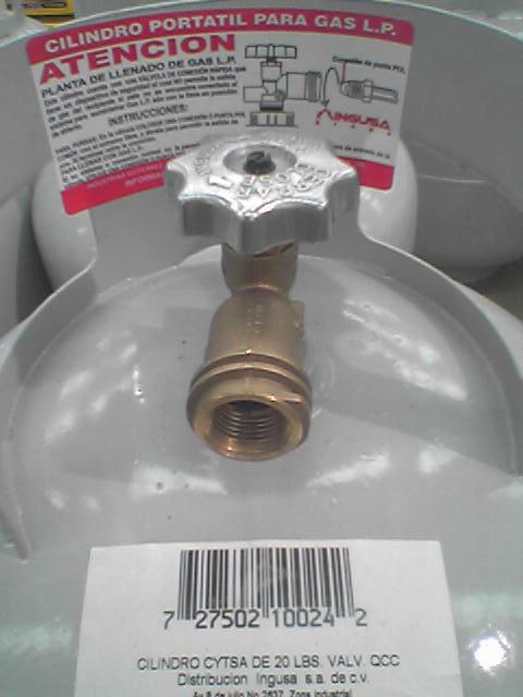

My last propane thread got thuroughly hijacked. If this keeps up, I will get so confused that I will end up building a skateboard instead of a Teardrop!
I was at Costo yesterday with my bride buying groceries. (We unfortunately got our children used to eating every day. $$$$)
Well, I snuck off to look at the new propane tanks (369 pesos --about 35 U.S.-- for 20 pounds). I am wondering if this Mexican tank has the necessary proper "new valve" on it?
Here you can see that it has both the outside and inside threads. I had never before seen one like this!
Thanks in advance!
Dr. Steve

Yep, that's the valve they are using now. Probably will until they come up with something more costly so we all have to change everything again. It has the inside thread so you can still use the connectors that are on your grills and whatnot.

you would not be able to get that filled around here in ohio. They don't look at the valve or the threads, the shape of the handle is all they look at around here. The new tanks have a handle that has three sides, if you have any other ones they will not fill them.

Granted, the new valve has a three sided knob, but it's the new valve which must meet U.S. specifications, not the knob. The knob can easily be removed and replaced with an older star shaped one. I have a brand new bottle (with the three sided knob) and the connection on the valve looks the same as in Dr. Steve's picture.

Since October 1998, all new propane tanks sold in the USA have required the new valve with a built-in overfill protection device, OPD. This type of valve contains an internal device that prevents tanks from being filled with more that 80% liquid.
The triangular shaped handle is just a standard used for easy identification the valve contains an OPD.
Follow this link to the Propane Education and Research Council's website for more details. http://www.propanecouncil.org/newsroom/press_releaseDetail.cfv?id=38

Yep that is the new one.
They are finaly here in Mexico. I saw them in Sam's also.
