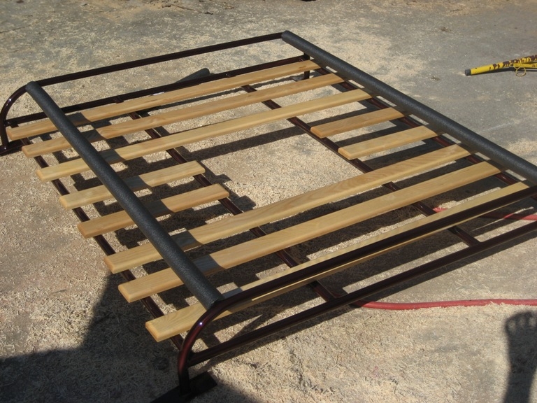

I built a few about 4-5 years ago using Electrical Conduit (painted). Very easy to fabricate...and Cheap! I don't think I had $15 in each one (the Cedar & Varnish costs the most)

Did you set up a jig for the bending ?
I assume a heatgun to soften the pipe ?
What sort of weight would those rack carry ?

Do you have to do anything special when welding the conduit? Does the galvanized metal cause problems when welding?

Yes you can weld it. Alot of people grind off the galvanize coating then weld.

I used 1/2" EMT (Electrical Metal Tubing) on one (Pac-Man) and 3/4" on the other (SlumberCoach). I liked the 3/4" better.
Yes it is Galvanized and that can cause some respiratory problems when welding.....but a fan blowing across your welding area cures all that.
I used an EMT bender, a $2 yard sale find or $20 at Home Depot new, a grinder to cut the scallops in the cross members and my Trusty $90 Harbor Freight Welder.
Easy Peasy and lots of fun to do.
Lancie49 wrote: What sort of weight would those rack carry ? Lance
I carried 2 kayaks on it sometimes and 75 to 100lbs of gear on it others....never a problem.

You can achieve flawless scallops with a hole saw the size of the tube, a drill press and a vice. Perfect every time when you start cutting dead center on the tube

Yes, and on larger diameter pipe that may be a viable option.
However!
On a 3/4" pipe by the time the "curved" excess gets jammed in the hole saw...and the time, and effort it takes to clear out the excess to get ready for the next cut.... some times 30-35 times a Rack.
Its easier to grind them.
One of those theory vs. practice things.

^^^^^^^^^^^Yep, you can cope a piece of EMT with a rat tail file in less time than it takes to fool around with the holesaw.
I did a bunch of pieces for a project a few years ago. I made a hardwood jig. It had a hole that the tube slid into and a half round groove running perpendicular to the hole. Stick the tube in until it flushes with the top of the groove and file away. I did split the jig with a groove running parallel with the hole so it would squeeze down and hold the tube in place when clamped in the vise
