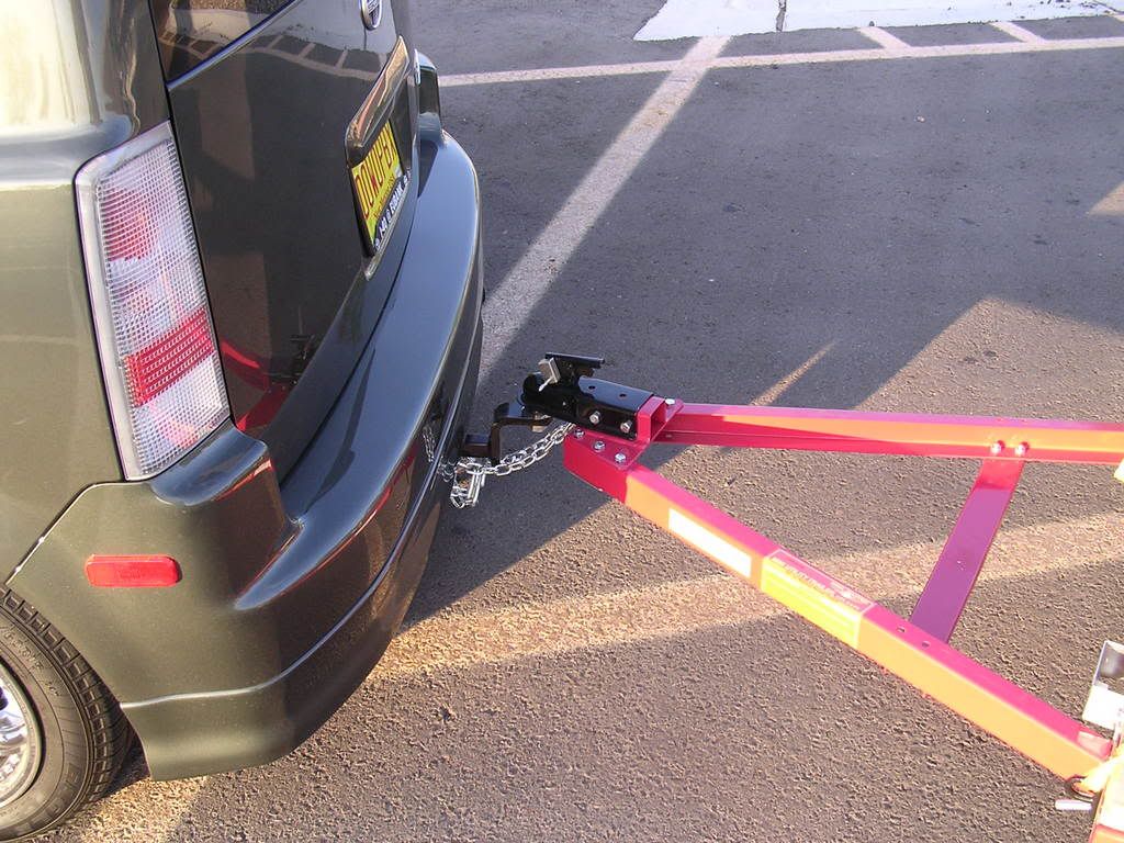

Postby DoWopBox » Fri Sep 16, 2005 9:56 pm
BillInTampa wrote:Hi DoWopBox,
Did that hitch bolt on with no problems? Did the receiver come out under the rear skirting or did you have to cut an opening in it? Lastly, what design are you building and what do you think the all-up weight of it will be? I'm trying to keep mine light as I'll be dragging it through the mountains of Tennesee, Georgia, and North Carolina.
Thanks,
Maybe this will help. The Hitch went right on, took me about a half hour to install it. It uses the original factory shipping-hook boltholes that are already threaded. It goes underneath the rear pan.
(Click for larger pic)
I'm going to try to keep it under 900 pounds. I still haven't decided on a final design, I'm still gathering the materials and tools. I'm thinking a modified Benroy at this point tho.
