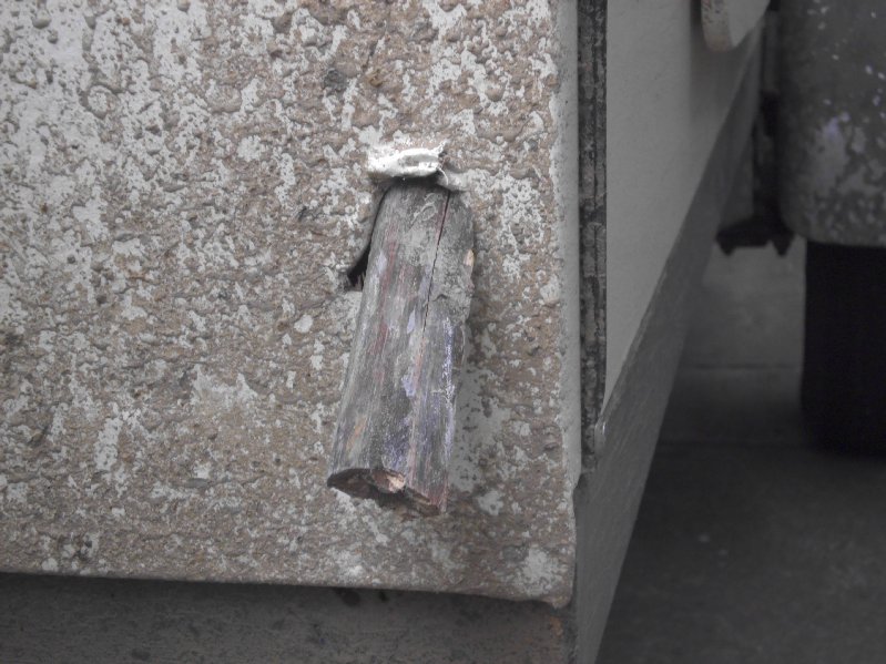

We travel different roads down here Rob.
I took this TD on it's first run a coupla weeks ago, stopped at the camp on the second night and found this. :o
Also note condition of freshly painted mudguard........................... :roll:
:thinking: Yep, I reckon I need a sheet o steel :thumbsup:

Postby Corwin C » Sun May 06, 2012 7:18 pm
Wow ... did that limb go all the way through? From the looks of it, even steel would be hard-pressed to come through unscathed.
When off-road, I'm more of a "crawler" type than the "let's throw mud so high it'll take weeks to clean up." I'm wondering if mitigating the source of the debris with mudflaps/guards on the tow vehicle wouldn't be more effective and easier to accomplish than armoring the trailer. :thinking: Don't know what to say about that hunk o' wood. :NC

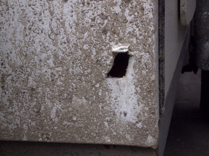

Postby Lancie49 » Mon May 07, 2012 3:43 am
I tend to do a lot of dirt roads, simply because we have a lot of dirt roads down here but this particular incident was a little unexpected.
It was only a small branch that I must've kicked up (about1 1/2" dia) but it must have been the angle it came from that did the damage. Yep, right through the outer skin.
I've got a good set of flaps on the Pajero but those TD mudguards are directly in line. I'm a signmaker and I have a product called AutoProtect that I'll be putting on the guards, after I repaint them............ :oops:
I think I'll be glueing a steel sheet across the front and covering that with rubber to prevent stones and gravel bouncing back onto the tailgate of the Pajero. We get a lot of rear window breakages like that.
This is the result of the branch contact.
Nah, nail polish just aint gonna work....................... ;)
