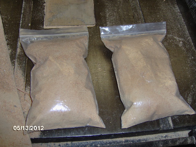

Okay, now you will all truly see what a novice wood worker I am when I ask if wood flour is just generic saw dust that I harvest off of the table saw, etc. or does it need to be fine like sanding dust?
I have a bunch of relatively uniform sawdust that I collected from ripping the slats,
but it is not the fine consistency of sanding dust or general purpose wheat flour (you know, the white stuff used for baking cookies). More like grits or flax seed.
If a fine flour consistency is best, is it a purchased product or homemade? If homemade, what is the best method to produce and collect?
My guess is that what I have here in the bags will do just ducky, but while I have your attention I might as well ask the experts.

Postby Larry C » Fri Jun 08, 2012 7:50 pm
Wood flour is a manufactured product. It is very fine. If you have a Random orbit or palm sander with a dust bag, the dust collected in that bag is almost the same. Don't use sawdust, it's too coarse and will just make a lumpy mess. Save your sawdust to mix with paraffin wax to make a great fire starter.
Actually wheat flour can be used as a thixotropic agent to thicken epoxy. There are many other thickeners available for epoxy. I mentioned wood flour for you application because it will make a smooth and strong filler. However, don't expect the nice tan color of wood flour or the dust in your sander bag to stay that color when you mix it with epoxy. It will turn dark brown unless you control the color with other additives. Also, it will be difficult to sand, so put it only where needed or you will have a lot of extra work.
