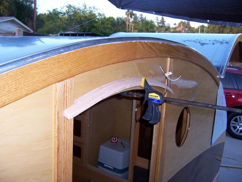

Postby Wolfgang92025 » Wed Jun 13, 2012 9:43 pm
Made my own.....
Made a cardboard template. Traced onto a piece of laminated oak and cut with a band saw. Top angle is steeper than bottom angle of the cuts to give it a nice profile. Used a block plane to clean up the saw cuts. Stain, several coats of varnish and epoxy in place.
Wolfgang
