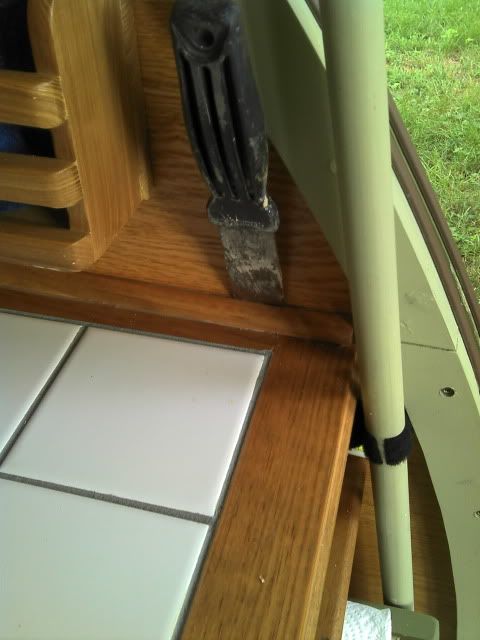

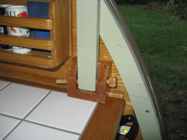

Postby BillZ » Sun Jun 17, 2012 8:54 am
Becky,
Ours came with broomstick type poles that pinned at the top and had a velcro strap at the bottom securing it to the inside of the wall.
They worked great but they would be in the way of the lower cabinet doors I was planning to make at the time so I designed something different.

Postby Oldragbaggers » Sun Jun 17, 2012 9:53 am
I really like what you designed Bill. Thanks for the great pictures.

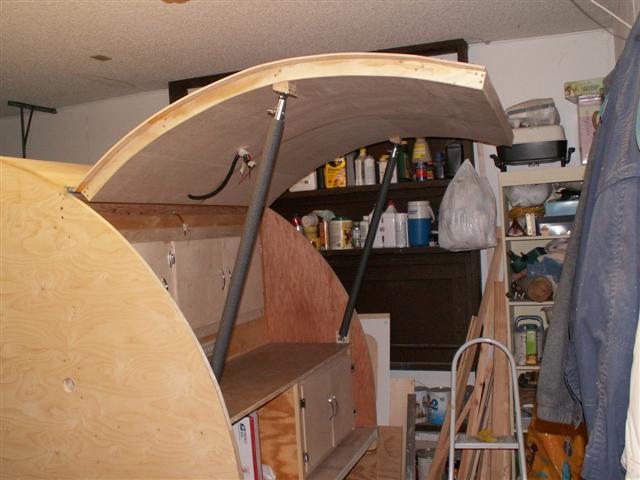

Postby Forrest747 » Sun Jun 17, 2012 10:35 am
http://t2.gstatic.com/images?q=tbn:ANd9GcRrsCtvyTUPf84opp1sdAbyNmNtQhKr0537YxNW6A70a-0hT_Ec8A

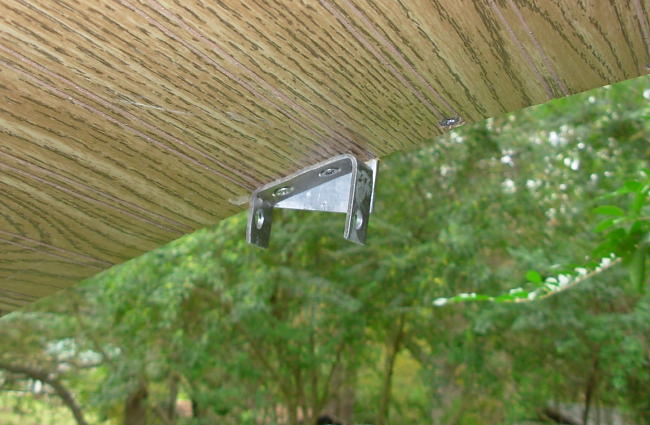

What I really wanted to do was do something like a bimi mounting bracket but I had a deadline to get it ready for the first trip and went with something I knew I could get and install the night before the campout. I have them mounted on outside of the body. I am having a hard time drilling, screwing or attaching anything to the cherry.
What I did was took some strut supports. It has a ball on it that is attached to the mounting plate by a tapered cone. I took some 3/4 emt conduit and cut at 5 feet. Drilled a hoke at each end just big enough to put the ball in and hekd in place by the tapered. cone. I need to come up with some way of holding it against the mounting plate so it doesn't find its way out. So far its working ok.
Update: Ok found a way to hold them in case of wind. just took a couple of mini bungee cords and wrapped around twice and used d-rings to tie it all together. i like the look and it functions well. I also moved teh brackets to inside and found a nice spot to attach them really happy with them.

Postby Nobody » Sun Jun 17, 2012 10:36 am

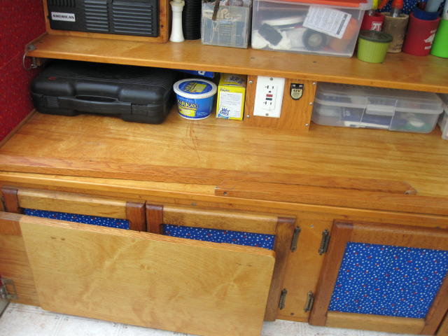

Did mine very similar to BillZ 'cept mine are hinged at the counter top & swing up to the latch. Didn't want to try to devise a holding mechanism on the hatch interior to keep 'em from flopping around while underway. I formed the upper receptacles from heavy (1/8") aluminum plate & bought a couple of tractor 'lynch pins' as 'keepers' so wind won't move the hatch while in up position. Didn't want the pins 'tethered' to the posts since they could also move a lot while underway & damage the counter top, so I drilled a couple of correct size holes at an angle in the upper counter top for pin storage while underway. Been using these since 2006 & they work great. Only problem is my tiny wife has problem lifting the hatch high enough to engage the props so that's my job. Up 'til now that ain't been a problem as I've always been available & she don't camp alone 8) .

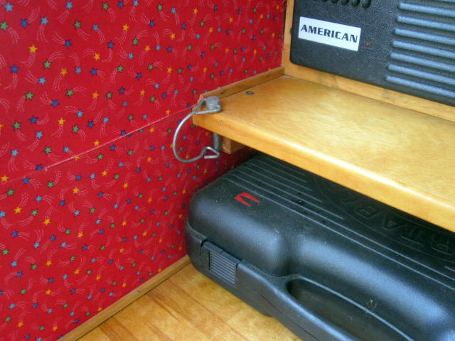

Postby LDK » Sun Jun 17, 2012 12:06 pm
Hi Becky
This is how I did mine. I got the basic idea from Harvey (Nobody).
It works really good and is very stout. Its easy to get the pins in and out too.
I may try to skin the inside of my hatch but I'll have to leave some room for the hatch props to
seat properly. I'll have to think on that alittle. :thinking:

Postby Nobody » Sun Jun 17, 2012 1:27 pm
LDK wrote:Hi Becky
:thinking:
Larry, that's exactly the reason I devised the upper latchs the way I did. I used mine for a couple of years with the inside of the hatch 'bare' & had near the same pin arrangement you have. Had to figure something different when I 'lined' the hatch so I came up with the aluminum 'receptacles'. I'm sure there are others that would work as well, just I had the materials on hand & easy to work with. :thumbsup:

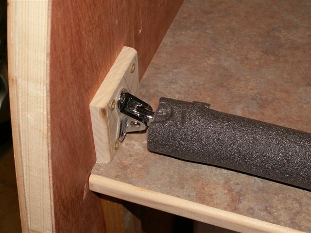

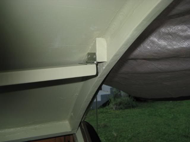

Postby Toytaco2 » Tue Jun 26, 2012 7:31 pm

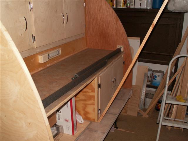

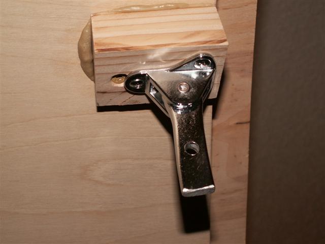

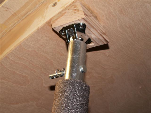

I used conduit with foam pipe insulation along with folding door stops. I cut the end off the door stops and drilled holes in them. The "stubs from the door stops fit inside the conduit. On the bottom the conduit is bolted to the stub and on the top I use a locking pin. Simple setup, but its solid as can be and a high wind can't lift the hatch. Its also pretty inexpensive.

Postby Oldragbaggers » Tue Jun 26, 2012 8:50 pm
Very creative Mike. I like that a lot!! Thanks for sharing it and for the detailed pictures.
