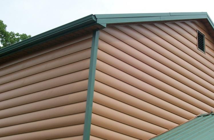

Here's another steel siding profile that mimics log siding, both the milled full log with splined flat top and bottom and the 1/4 log wood siding that goes on like shiplap. This product is roll formed on the jobsite from the same 26 gauge vinyl coated steel as the trim coil but an additional wood grain is embossed in the rolling process. It is backed with a matching profile of styrofoam to provide rigidity and maintain the shape.
I will use this on a future build that will be about 12 foot long, 6 foot wide,and 6 - 1/2 foot at the inside peak of the roof. There are some limitaitions - to make it look natural straight vertical walls and a gable roof will be part of the design, It's use will be as a base camp but would not be any more of a problem to tow than a cargo trailer of similar size. I will probably have a v-shaped front wall to cover the a/c and tongue box.
I have seen some other log motif trailers but those were either painted or in one case used the 3-4 inch diameter core posts (super heavy). The steel can be installed directly on studs but sheathing is recommended - the foil faced 1/4 masonite works well or 7/16 OSB. House wrap should be applied over either. The steel weighs .9# per square foot and each individual horizontal panel is 8 inches high and 1 - 1/2 inches thick. Each successive lap hides the fasteners of the one below. The roof will be either a standing seam or metal shake.
