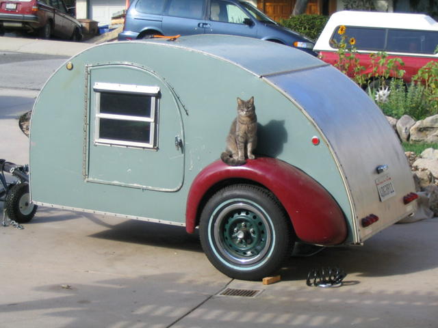

Postby s4son » Thu Sep 22, 2005 6:03 pm
Ma3tt wrote:$12 2 sheets of 220 grit paper and 4 cans of rustoleum........
Its called a 15 foot paint job...... it looks good from 15 feet!!!!
Ma3tt,
Did you use this method for the body as well? It looks like it would stand up to an inspection from closer to 15 feet to me. Nicely done.

yep a $12 chipped up paint job or a $$$$$$ chipped up paint job.. at the end of the day its dark.. I have painted my tear twice and each time it was like a brand new toy, it encouraged the wife to redo some interior stuff to match(Good Move). If I had spent $$$ on it the first time it would still be that split pea green with a cat stuck on it!!!! YUCK!
