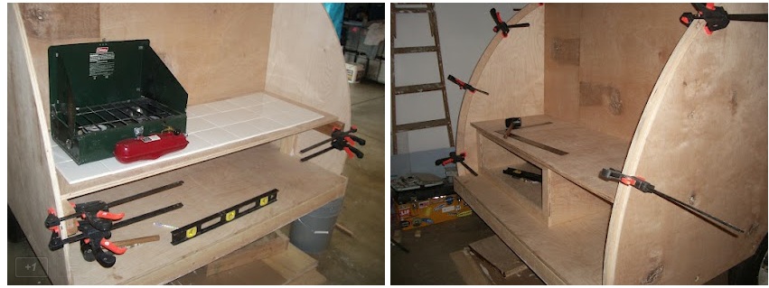

I'm starting to work on the galley and I'm considering using some ceramic tile I salvaged from my kitchen remodel. I'm concerned the vibrations of the traveling camper will constantly dislodge the tiles or grout. I don't want to be re-bonding the tiles after every camping trip, but I do like a more durable counter top than just varnished plywood. My wife is agreeable to either decision.
In a test, I laid out the tile on the counter top to see what it might look like. My thought it to router out a base to lay the tiles. Once I do the routering on the top, I'll be committed to the tile.
What do you think and if you have tile in your galley, how did you bind the tiles to the plywood? Thinset doesn't seem like the right way to go since that is brittle and susceptible to the vibrations.

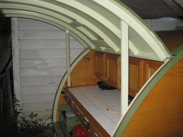

Our Tear was built in 2008 by forum member B Bodemer. It has a tile countertop and there has been no cracking at all so far. Between the 2 owners, I would guess it has been on at least 20 trips all together.
I really love the tile and think it is a unique addition that you don't normally see in a camper.

I used glass tile for our galley counter. The counter was 1/2" plwood. I adhered the glass tile to the plywood using PL Premium. Later, I came back and filled the joints with epoxy tile grount. It has held up quite well - no popping of tiles or cracked joints.

I used PL premium adhesive and it worked like a charm and like Tom i did an epoxy grout and loved how it came out. (Thanks Tom)
