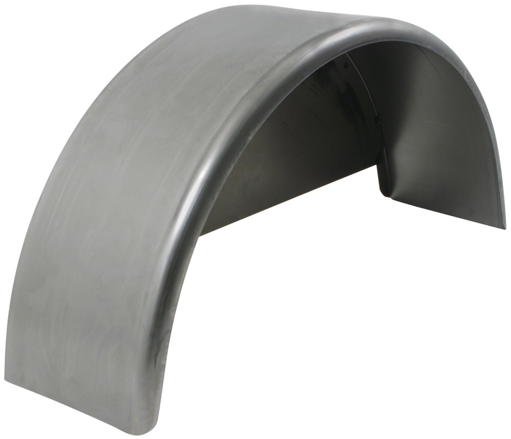

My fenders came yesterday. I had ordered the widest fenders I could find for a 14-15" tire. They are 11" wide. But I still have a good 3/4-1" of tire that sticks out beyond the edge of the fender. Would any of you opt to leave that tire sticking out beyond the fender? Is that even acceptable?? (Oops....I guess that's 4 questions.) :oops:
This is my fender and I had hoped to bolt or screw it to the side of the teardrop through the back plate.

Thanks everyone for the good info. I measured the fender width as an afterthought. It looks to me like they include the lip and the rollover in the width measurement, so it actually only stands off from the trailer wall by 9". I was perplexed by why it didn't cover, because according to my measurements it should have. I just didn't understand the way they measure. I am going to call the company as soon as they open this morning, but this is what I am assuming.

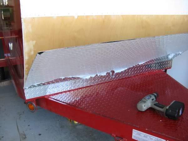

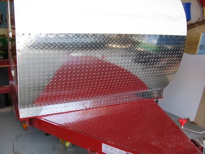

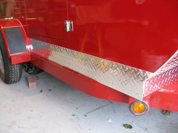

Becky check sign supply companies in your area and some care aluminum sheets. I found one here in Atlanta that sales .040 and .063 in 4x8 sheets. I plan in getting some to do a rock guard on the front and use the other sheet to do a 6" border of it around the bottom of mine.

Cliff (& Becky), I bought a 4x10 sheet of 0.063" diamond tread aluminum (wouldn't want to try to 'manipulate' anything heavier) when I was building my TD. Used part of the sheet for the 'rock shield' on the front & the 6" bottom trim pieces. The rest went to make the tongue box with enough scrap left over to replace the bottom trim under the hatch when I was rear ended in 2010. The 0.063: diamond tread was kinda difficult to form properly to fit the radius on front of my TD but it is sturdy enough to withstand some pretty heavy road debris...

Weird thing with my fenders. As I said, they were too narrow. But I had measured the distance before I ordered them so it was kind of baffling why I had tire sticking out. And then, yesterday morning it occurred to me that I should measure the fenders (...duh...) and sure enough, they only measured 9" wide. I was assuming they included the lip and the rollover in the width dimension, but no, It appears they sent me the wrong fenders. When I called the company, the rep says they should have infact measured 10.75 wide. They are delivering new ones and picking up the old ones. Thank God I didn't start painting them, and why measuring them didn't occur to me immediately I don't know, but I don't need the spacers now!!

I used .063 diamond plate for my rock guard and trim. Plenty thick enough for the job.
