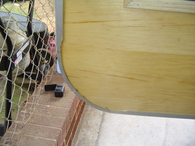

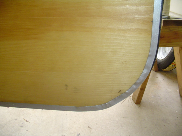

Something I learned. If you use the HD 1/2" angle for the inside of the door (Use TD Fix it Shop T moulding for the outside) In the short radius trim the moulding down to 1/4" on the side that bends. Makes a huge difference and looks great.
Trimmed
NOT trimmed
