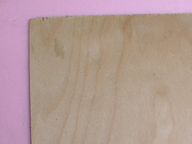

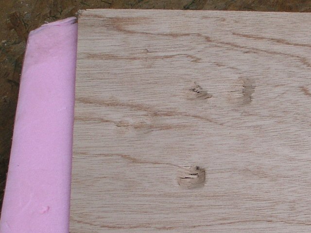

I just tried a very unscientific experiment. Using 3/4" EPS as a backing material, and a ball peen hammer as the weapon of choice, I gave this piece of 1/8" luan a medium force hit. The results were less than favorable.
Then I took a piece of 1/8" baltic birch and gave it the same medium force hit. It barely made a dent. And baltic birch bends easy enough if you bend it with the grain. And it's available if 5'x5' sheets. I think that baltic birch will be my first recomendation, and 2 layers of 1/8" luan will be my second.

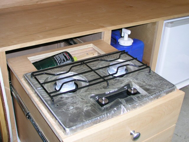

As for the rest of it, I'm making some progress. I am using 1# bottles for the stove after all. I have it set at the optimum angle to boil the propane. Now I need to have a hose/tube made.

All I had was birch ply, Mike your pictures sure beat the hell out of me just describing it
:applause:
I think it shows 1 layer would be good enough as long as it wasnt luan

The optimum angle is the angle that exposes the most surface area of propane inside the bottle without blocking the flow out the top when the bottle is new. It might be between 15* and 30*. I'll measure a couple appliances I have this evening.
