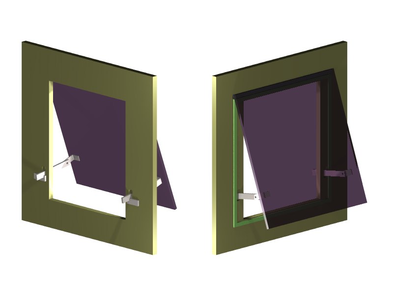

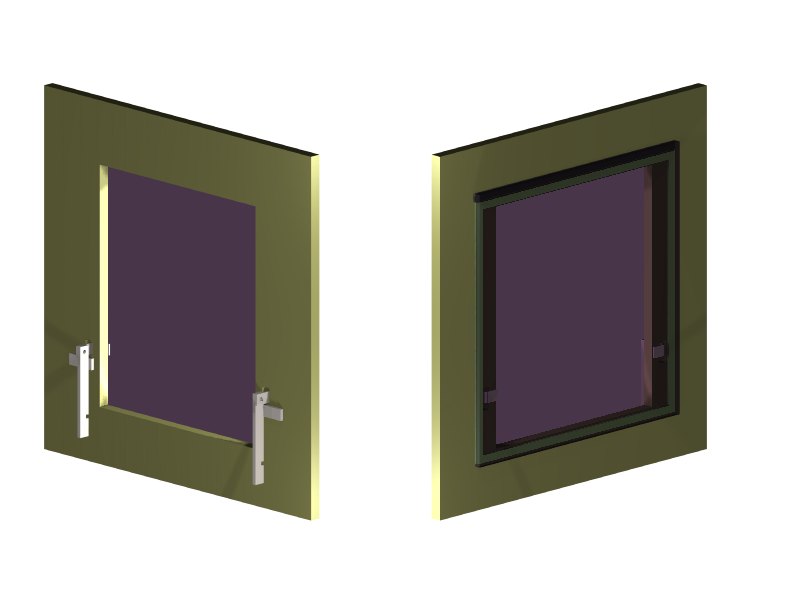

Postby angib » Mon Aug 27, 2012 10:06 am
Well, here's my suggestion for a home-made window:
The 'window' is just a sheet of plastic (argue amongst yourselves whether polycarb or acrylic is better) which is hinged at the top with a piano hinge and seals onto the outside of the sidewall with a weather-strip all round. It'll need a cap over the top to stop the top seal from getting flooded.
A screen fits in the rectangular opening, but isn't shown - it's hard enough showing the detail without trying to find some way of modelling screen material!
The stays/catches are also home-made from 3/4x1/4 and 3/4x1/8 aluminium strip. The stays pass through two holes in the sidewall that have keeper strips mounted at their bottom. When the window is open, a notch in the stay locks into this keeper strip, and when the window is closed, the two stays hinge down to press against the keeper strips and hold the window tight against the seal. Clip the bottom of the stay to the wall (not shown) and you've got a secure lock.
One possible problem is where the stays hinge on the brackets that are fixed to the window - ideally these need to be rivets, so that they will pass through the small holes in the sidewall. If a bolt was used, the hole in the sidewall would have to be bigger and maybe big enough for bugs to come through.
angib
5000 Club
5000 Club
Posts: 5783
Images: 231
Location: (Olde) England
Re: Homemade windows
Postby working on it » Wed Aug 29, 2012 8:49 pm
Andrew- I really like your window design, you keep the ideas coming! ; I think it will be a better choice for me to use than a Wiley window (I want to be able to remove one window and replace with an A/C unit when needed) The Wiley wedges and lack of removable screening are resolved with this design. The only changes I would make to your latest design would be to (1) the exterior screen frame (at least it looks to be outside to me) : it could be moved to the interior (my preference, easier to take care of, not likely to be damaged in transit) by either narrowing the sidewall opening or moving the stays further outboard of the opening (wider lexan? required), and (2) making "fuzzies" to seal the stay holes : (similar to window "fuzzies" that cushion and seal the roll-up windows on "classic cars"). They could be made from brush material, or foam weatherstrip, just to keep the bugs out. Also (3) Replace the "piano hinge" with a detachable hinge (on the A/C mount side). These changes are just for my particular preferences...otherwise it's perfect as -is!
