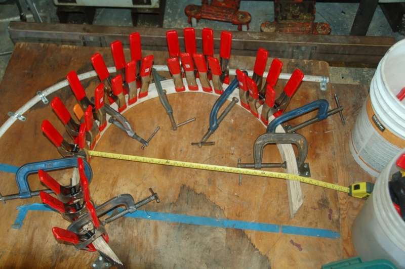

After a number of "distractions" I got back to laminating my "test" rib for my galley hatch. The results exceeded my expectations.
Key learnings:
1- The rib is verrrrrrrrrrrry stiff.
2- Absolutely no springback when removed from the jig.
3- A bit of glue got on the face that will be exposed and discolored it. Covering the exposed faces with masking should solve this issue.
4- I used vice grip clamps to clamp the glued up rib to the angle iron jig brackets (about 6" center to center) and spring clamps in-between the the vice grips. I got
about .030 variation in thickness (not that it matters) along the length of the rib. Using C-Clamps rather than spring clips will probably reduce this.
5- The rib is 5' long but longer ones could be made by staggering the plys.
6- I used tightbond 2, laid on a generous bead with a squeeze bottle and rolled it out with at small sponge roller.
7- I wrapped it in plastic to contain the mess but next time I'll just put plastic down on the plywood form draping it over the angle iron brackets to prevent sticking.
8- Belt sanding the edges worked well but I may make a jig to hold my router and route the exposed edges down just a tad to get an exact thickness. Why, because I can.
9- Most of the bend caused by the "preforming" didn't last. No need to pre-bend the ribs prior to laminating.
10- The little angle iron brackets were not exactly square with the base of the jig so I tweaked em to be square with world before I laminated the rib.
To Infinity and beyond or at least the count of ten.
Cheers,
Gus
