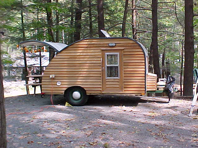

Postby M C Toyer » Thu Sep 27, 2012 12:36 am
This just came up on the Hall of Fame rotation:
User name is goldcoop - I don't look for his build thread
M C Toyer
Posts: 363
Images: 11
Re: Vinyl siding option?
Postby goldcoop » Thu Sep 27, 2012 5:05 am
M C Toyer wrote:This just came up on the Hall of Fame rotation:
Hey that looks familiar! :lol:
I used western red cedar siding, basically glued to a luan skin. HEAVY! :roll:
I used Jeep fender well extensions for my corner molding to cover the lap joint gaps particularly at the front end.
Cheers,
Coop
