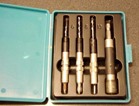

Seeing a thread where the pocket hold jig was discussed, reminded me of a valuable tool for building TDs, and I finally found mine this afternoon while cleaning my utility room. It's a combination, quick change countersink and screwdriver tool by Makita. It countersinks for screw sizes 6, 8, and 10. I'd recommend this handy tool for anyone who drills a lot of countersink holes for screws.

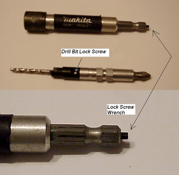

This next pic shows the main attachment for the drill or electric screwdriver that holds the quickchange drill bit, and one of the 3 combination countersink drill and philips screwdriver bits. The screwdriver bit is changeable to flat or square bits and it is magnetic. The drill bit is a special bit with a flat area on the shank to lock it into place. The #8 bit adjusts for depths of 5/8" to 1 7/16" by loosening a hex lock nut that locks onto the flat portion of the shank. The attachment that goes into the drill has the hex key built into the end of if, so you never have to look for a hex key to adjust your drill bit.

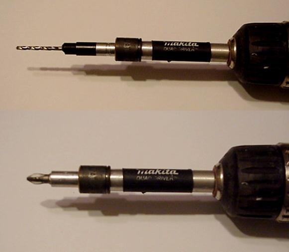

The next pic shows the bit holding attachment in the drill with the quick change piece with the counterdrill drill bit out, then with the screwdriver bit out. All you have to do is adjust the drill bit depth, drill the countersink hole, silp the piece out and reverse it to drill in the screw.
I broke off my #6 bit, but think I can use my grinder or a file to flatten an area on the shank of a regular bit that fits the piece, so that I can lock it in place.

Good comments. My Makita bit case is green and has the name molded on it if that helps identify it. My bit holders are aluminum where it slides into the attachment on the drill, but hasn't been used enough yet to give problems slipping in and out (but will be used when I start work on the trailer). Nor has the lock nuts worn out.

Randy, did you replaced the bit with one with the flat faced shank, or a standard bit? I'll have to replace my #6 screw bit before I can use my set. The lock nut will hold a flat sided shank bit better than a standard round shank.

i use the flat face shank bit. it allso comes with a allen screw to replace the old one. i think they come three to a package. once in a while put some oil on the locking ring.
