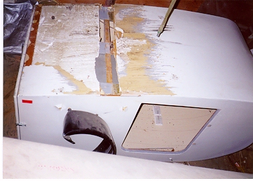

I think Vegabond wants to bolt the axle directly to the body of the teardrop, and I think he wants to bolt the tongue directly to the front of the body. No metal chassis at all...
The only person I know who tried that is John Blewett, the guy that built the Boxter... and here's what his trailer looked like after he went over a bump in the road!!!
Here's the story...
http://www.tinytears.cc/Boxter/Damage/damage.html
