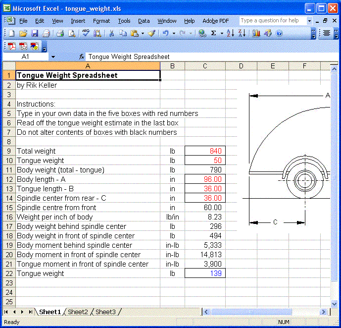

Postby mikeschn » Sun Oct 09, 2005 5:49 pm
Just for sh*ts and giggles, I plugged in a couple numbers to see what your tongue weight might be... 139#... wow, thats not bad at all! :o
