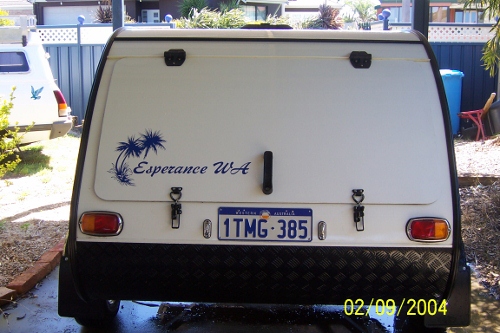

We used pre-painted steel to clad our Teardrop. Known as Colorbond in Oz. We used a nibbler to cut it to size.
The steel is glued on the ply with aluminum checker plate on the bottom sections to protect the steel from stone damage.
The weight penalty was minimal.
We had little knowledge of Teardrops when we built the TD, had seen a few pictures which resulted in some chalk outline drawings on the back patio. In hindsight there would be a few things we would do differently.
Take it easy.
SD

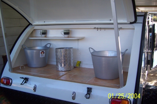

Postby Roo Dog » Mon Nov 26, 2012 6:44 pm
Woody,
Galley area.
Stowage under the galley deck.
The hatch is a mixture of aluminum and steel sheet as are the main doors.
It is a work in progress as most Teardrops are I guess.

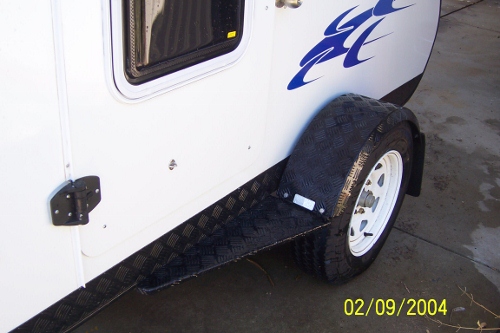

Postby Roo Dog » Mon Nov 26, 2012 7:07 pm
Woody,
A couple more.

Postby woodywrkng » Fri Nov 30, 2012 7:25 pm
I like it. It looks more like something made in a factory as opposed to made in a garage. The hatch is unique. How is it hinged?

Postby Roo Dog » Fri Nov 30, 2012 8:44 pm
WW,
'Owisya ?
SIL and myself built the wee beastie.
The hatch hinges are the same as the side door hinges. Plastic gate hinges ex the local hardware store, externally mounted. The roof hatch is a marine product.
Door windows are stock caravan wind outs.
