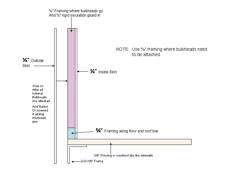

NOTE: Drawing not to scale
Also, for all you guys that have the frame hidden, how did you treat the front and back?

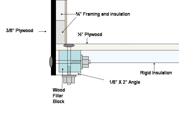

toypusher wrote:I am planning on building a 5x9 frame out of angle iron and was trying to figure the best way to attach the teardrop and also cover the frame without losing interior height. I want to keep the overall height at 4ft. Here is a drawing of how I was thinking to do it. The drawing shows bolts, but some of them would probably be just screws (like to fasten the floor down.)
doug hodder wrote:Not to be devils advocate here...but if you flopped the angle so that you had a flat surface for the deck to lay on, wouldn't it allow the water to drain out better and not get trapped between the wood filler block and the iron?...I would think it might minimize wood rot....and you will still have the flat iron on the exterior...at the point of axle attachment...you could just box the angle with another piece of angle making it 2x2 tube....for through bolting, just back up with a hefty washer....I'm thinking about an angle frame for the next one...had good luck building them in angle for motorcycles years ago....Just my thoughts on it.....Doug

madjack wrote:doug hodder wrote:Not to be devils advocate here...but if you flopped the angle so that you had a flat surface for the deck to lay on, wouldn't it allow the water to drain out better and not get trapped between the wood filler block and the iron?...I would think it might minimize wood rot....and you will still have the flat iron on the exterior...at the point of axle attachment...you could just box the angle with another piece of angle making it 2x2 tube....for through bolting, just back up with a hefty washer....I'm thinking about an angle frame for the next one...had good luck building them in angle for motorcycles years ago....Just my thoughts on it.....Doug
...yeah, what you just said...that's is my thought for a frame for the NEXT one
BufordT wrote:madjack wrote:doug hodder wrote:Not to be devils advocate here...but if you flopped the angle so that you had a flat surface for the deck to lay on, wouldn't it allow the water to drain out better and not get trapped between the wood filler block and the iron?...I would think it might minimize wood rot....and you will still have the flat iron on the exterior...at the point of axle attachment...you could just box the angle with another piece of angle making it 2x2 tube....for through bolting, just back up with a hefty washer....I'm thinking about an angle frame for the next one...had good luck building them in angle for motorcycles years ago....Just my thoughts on it.....Doug
These two guys have got it right. Check with someone on the board who has an original Benroy and ask how the frame was done. Mr. Ben and Mr. Roy had the angle flat. Then attached the sides over the angle as they came over. Those old timers sure did know what they were doing. And guess what they didn't overbuild.
