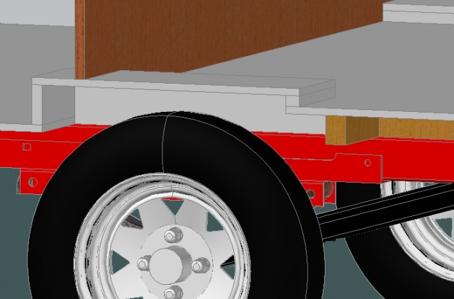

I do know that from axle cradel to top of fender is 4 3/4 inches I am just not certain how deep the factory channel for the frame is. 2 1/4 is my best guess. So top of fender to frame might be 2 1/2 +/- I am certain that 3" will clear it. I used a 2 1/2 square tube frame and tossed the factory channel as mine had been in an accident.
DO Not crowd the fender is you bend it downward you will cut a 12" tire in half with the bolt in the top of the fender. I would suggest leaving the fender but replace the top bolt with an elevator bolt and place thread and nut up not down.
ask me how I know........Image

I placed a 2 1/2 inch tube on the axle cradel (this replaced the 2 something frame tube)
On this 2 1/2 tube was placed a 3/4 floor and then I added a 1 1/2 curb around the opening that I had left for the fender so 2 1/2 + 3/4 + 1 1/2 = 4 3/4 inches if your frame is 2" thick and you subtract that from the 4 3/4 you arrive at 2 3/4 inches to the fender.
There is a bolt that protrudes a little more than 3/16 inch above the actual fender hence my arrival at 3" you are at 4" I think either will work.
look at pages 118, 117, and 116 in my album maybe the pics will help

Bob Henry, You know a picture is worth a thousand words where you used a 2 1/2 piece of wood, that is what I was wondering what should I use. Did you also build your Trailer Frame? I measured today and I have probably twenty five 1x4 by 12 and 16 feet long I will build a wood frame using the 1x4s and put them on edge I will have to build up probably 1/2 to 3/4 inch above that to clear the fender so I will just buy my ply wood in late Jan. I am not going to do anything special but I will be very thankful I have the wood already. you know about penny pinching. I will put in double wood and extra hardiness where I need to. The bolt situation and your tire is a lesson I will take to heart. I do understand and sorry that happened to you. I have a utility trailer I bought 18 years ago and had to replace the wood, I was very mindful to check the bolts on that (which way they went in) because I didn't want them to stick out and rub against anything (like me). but thanks again for reminding how much damage one bolt can do!!! Because I want light weight I am going to build using foam. it is just for this build for now. I have been thinking on how to design it so I can make it into a insulated woody looking one later on. Thanks again you have been very helpful . :D
