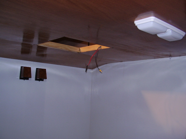

I used the "moisture resistant" luan for the inside and outside of my roof/ceiling. Inside I stained and pollyed it. I found some that looks like birch. It took the finish great and looks great. The outside I painted with a "Porch and Floor Enamel" to seal it up before I got my Filon. It took well and I almost didn't cover it with Filon except I was looking for the least amount of maintance possible. The Enamel probably would hold up well. The seams were my bigest concern (5' wide tear with seams every 4'). Mine is the 5.2mm thick (aprox 3/16"). Some of the pieces were as flexible as rubber and the Birch looking stuff was pretty stiff. To bend it for the inside I hosed it down for about an hour ("moisture resistant" luan). It got soffter and it did not delaminate or do anything bad. It dryed quick (granted it was summer in dry Denver) I did notice that the Birch looking stuff is thicker than the softer stuff.
