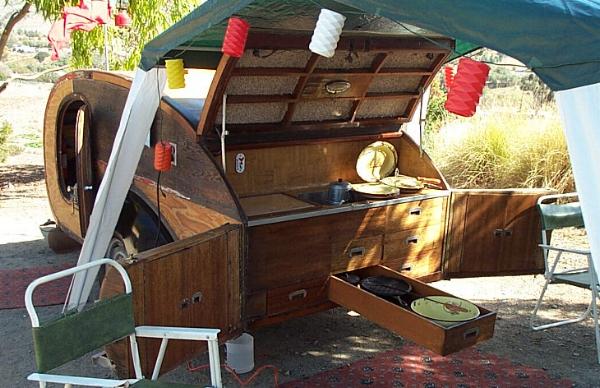

Postby angib » Tue Jan 22, 2013 3:29 pm
I'm including these photos of somebody's trailer as they are halfway relevant and I think this looks like a useful idea.

Re: Who's built side-opening doors at the rear of their TTT?
Postby Wolffarmer » Tue Jan 22, 2013 3:37 pm
Angib. Thanks for the memory jog. I have seen a picture of a similar trailer. Might be the same manufacture but the one I saw was a bit worse for wear. A good idea and I don't think it would be hard to make those rear doors and they have a bit of storage and would be a great place to put tail lights. I was thinking of making something like this on my next trailer but will probably go a different direction. But until it is finished who knows?
Postby Gage » Tue Jan 22, 2013 4:45 pm
Aw, I know that teardrop. It is believed to be a 1939 Home Built found in the desert of New Mexico. There has been a lot of work done to it to get it in the condition you now see it. And yes there are some nice ideas in it. ;)
