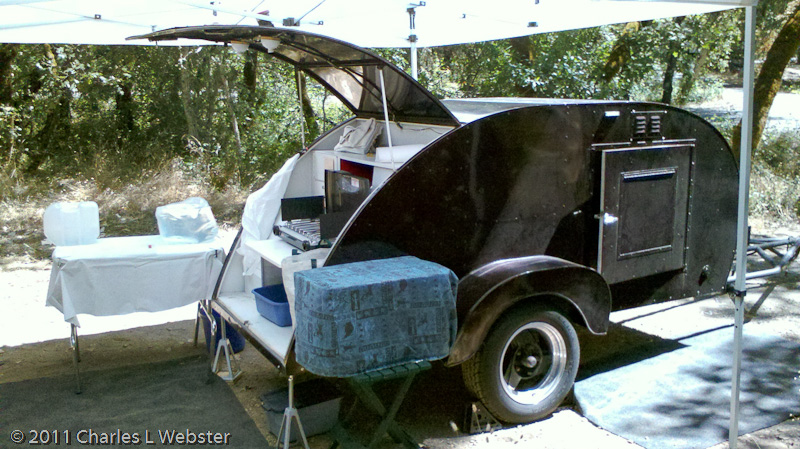

Postby Gage » Wed Jan 09, 2013 3:05 am
GuitarPhotog wrote:Because the trailer is still so structurally sound (mostly because of the way it's built), I didn't want to make any serious modifications, such as cutting a big enough hole for a larger fan, or installing a 2nd door. So I limited my renovation to work I could do with my simple tools and crude skills without making too many holes in the skin.
<Chas>
:beer:
So tell me Chas, did you happen to think about maybe going through the galley to get a hole large enough for sheets of ply for the interior? Just a thought. :thinking:
Chas's teardrop
PS: Are you going to make it to the Dam Gathering?

@Gage, the galley, like all the other features in my teardrop, is riveted in place, through both side walls. I even had to cut the insulation into strips so they would fit through the door.
The reason my tear is so "original" is that no one has been willing/able to drill out hundreds of aircraft-style rivets to move any interior features.
As for separating the body from the chassis, it might have been doable years ago before all the bolts rusted solid (65 years of exposure to the road hasn't been kind to either of us). When my TD was built, they started with a 4' X 10' sheet of 3/4" plywood. The set it on the frame (which connects the tongue to the axle) and bolted stuff in place. Then they built a body frame of 1" angle iron on the plywood, covered it all with 0.050" thick aircraft aluminum, and started riveting it all together. Sixty five years later, it's still intact and on the road.
