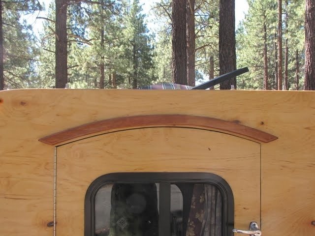

Postby nevadatear » Sun Jan 13, 2013 4:31 pm

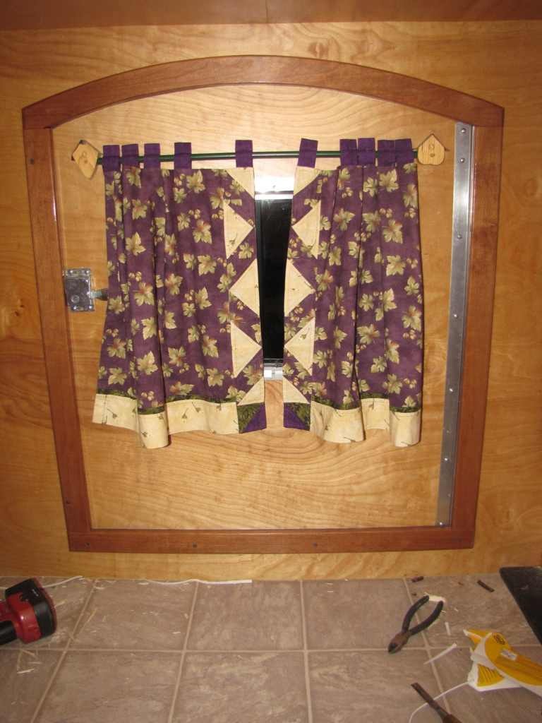

We routed out the side toward the doir to channel the water. These are cherry to match the tail lights.
. I have a better close up somewhere. Here it is

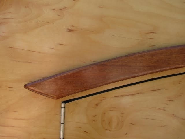

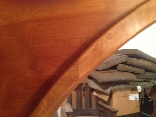

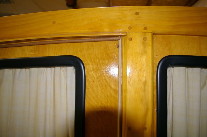

Postby nevadatear » Sun Jan 13, 2013 4:32 pm
And close up.

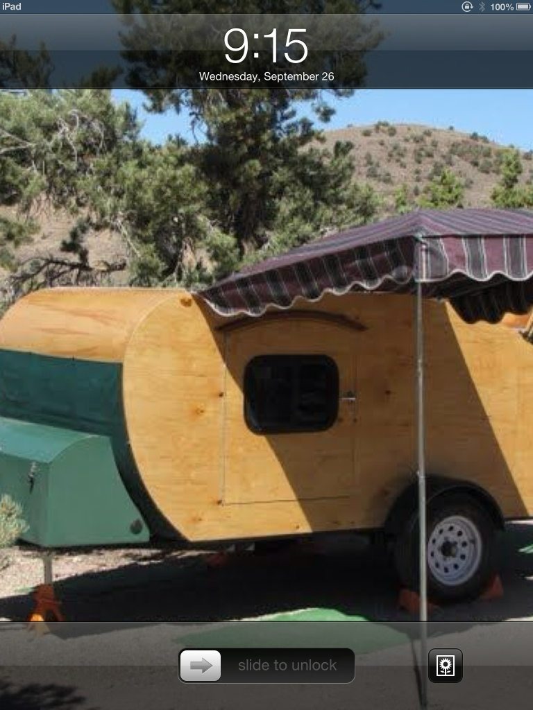

Thanks. My door is shaped diffently, and will take several cuts/pieces to make the radious if I cut out of planks. I figured best not cut it out of larger piece of plywood since I will need to rout the channel into it. See pic below:
[album]http://www.tnttt.com/gallery/image_page.php?album_id=241&image_id=85587[/album]
EDIT: I cannot for the life of me get pics to show up! And cannot find a simple, step by step instruction post on how to do it. I have photos in my gallery, and tried clicking on IMG and adding the URl between the IMG parentheses; tried doing the same using URL instead of IMG and linked it to photobucket account; and tried using the ALB feature, all with no luck. Frustrated and feeling dumb..

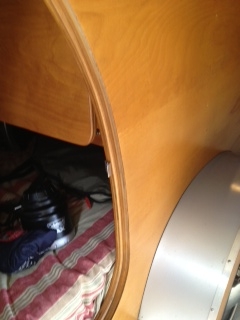

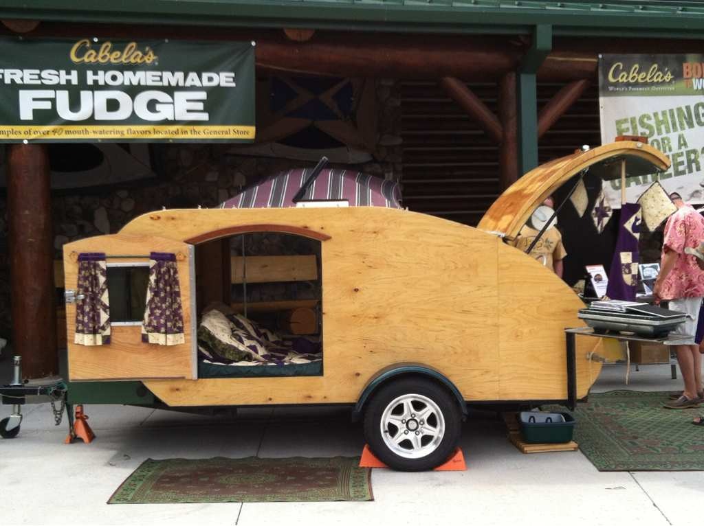

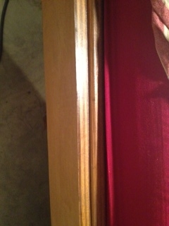

Postby driftwood » Sun Jan 13, 2013 8:25 pm
That would be probably be best. One of the challenges is that the existing "trim ring" (backstop) is cut out of birch plywood. Actually four pieces of wood glued to together to form one ring. Plywood is not "routable" is it (ie I could not rout some of the existing ring down to make room for a seal? I guess I could remove it, and use it as a template to build another just like it, then glue them together, and remount. This would leave gap for the foam to go. But then again, the height of the trim at the bottom is so small there is not much room for the foam seal to stick.

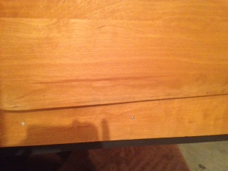

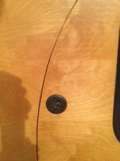

Plus, if the seal is placed on the trim ring where the door buts up to it, water can still get in the gap and channel down the gap to the bottom. It may not can get in the trailer, but would still impact the wood door at bottom as it is doing now. A few more photos below to help show the problem:
View of door closed
Cloesup of trim ring from outside
Trim ring from inside
Damage at bottom 2 inches of door (hard to see, discolored area above gap)

I can't find a good shot of the bevel on the wood at the bottom of the door opening, but here is one of the diverter over the door.
